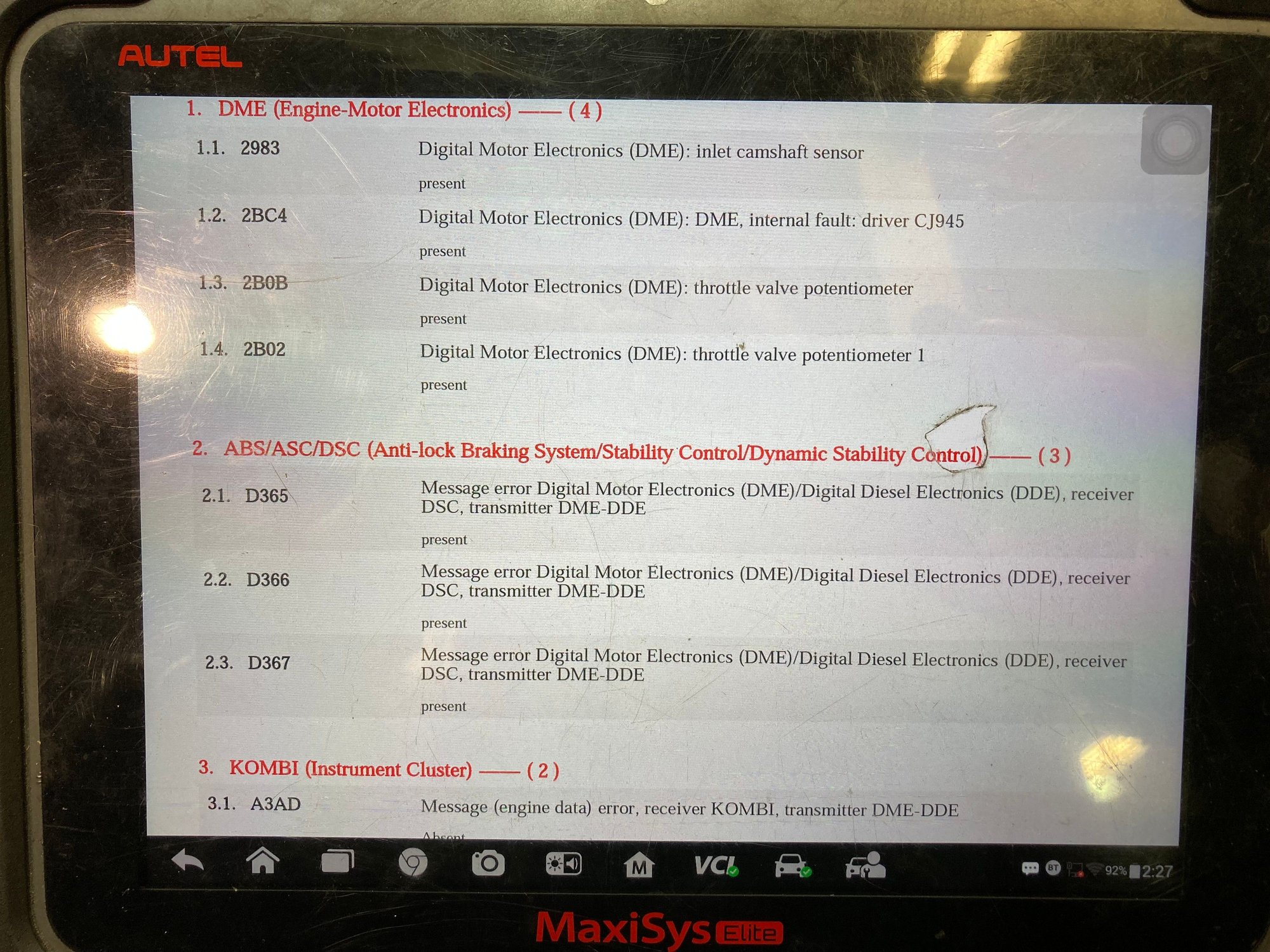

Looking for some advice on my ‘09 R55. I finally got the engine installed and it started fine. After about 4-5 minutes of running, CEL came on, fail safe occurred, then the engine shut down. Scanned faults and only fault in DME was ambient temp. sensor (the bumper was off). There were other faults in the DSC, KOMBI, EPS, and IHKA for communication faults with DME. These faults would set after 2-3 restart attempts. Then I finally got fault 2BC4: Internal fault, driver CJ945.

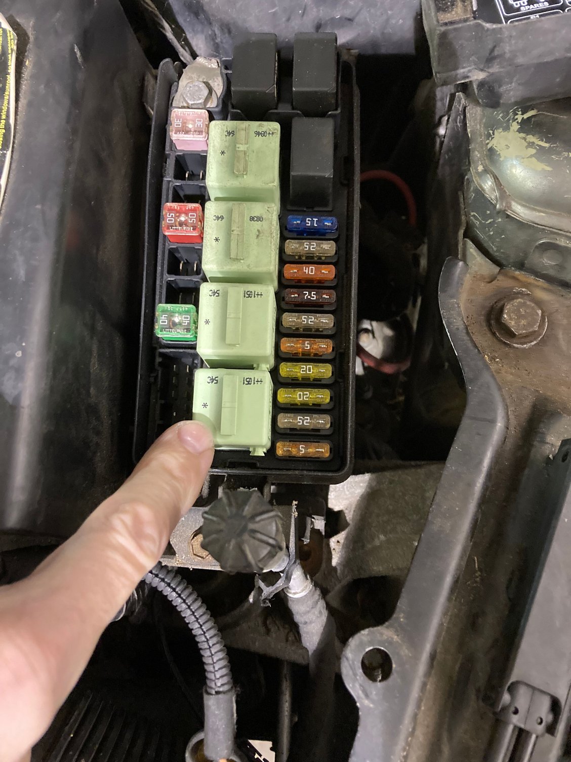

Cleared faults, and 2BC4 would clear, but then return, sometimes immediately, sometimes after a start attempt. Along with that start attempt, I’d hear a rapid clicking clicking from the DME relay, which would stop when I turned the car off. I believe this relay is why the fault is being set and the car won’t start. The fault in the CAS module is a hard fault. Also got the steering lock symbol sporadically.
I swapped relays with another MINI I have, but with the same result. Could this be a faulty CAS module? I don’t have a factory wiring diagram in front of me ATM. I don’t believe it to be a bad DME.

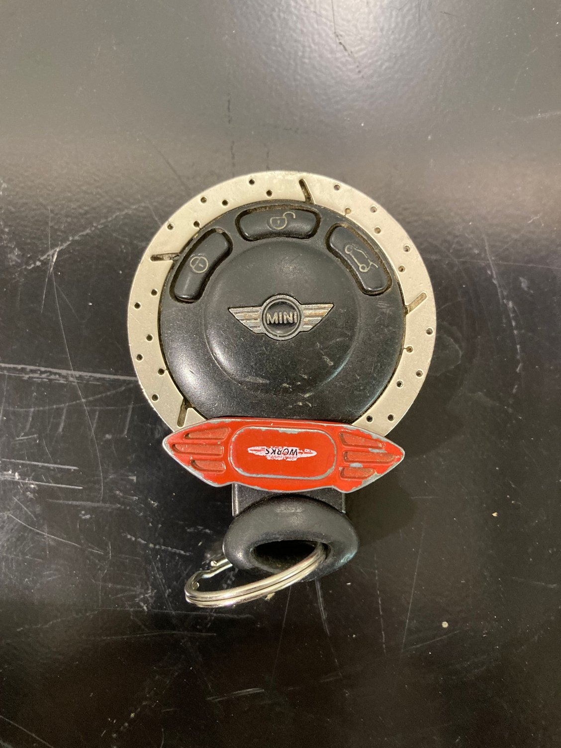

Side note: my R55 does have comfort access, but i don’t have a key I can insert into the slot. Pictures are below. First 3 are the faults I currently have, fourth is the relay I swapped (actually swapped both DME relays), and fifth is the only key I have. The other faults in the DME I believe to be erroneous as they didn’t show up for awhile and the car ran well until this issue started.

I started the car ran it for a minute, then shut it down to check a few other things on the car. I went back, started it up, and after about 4-5 minutes or running, mainly idling as it's still on the lift, it went into fail safe mode, then about 20 seconds later, it shut down. I attempted to restart it, and it started for a couple of seconds, then shut down again. tried to restart, and it just spun with meager attempts to start. The DME relay (pointing to it in the picture) clicks A LOT when the engine stops cranking. I swapped that relay and the one above it with ones from another Mini with the same issue.

The fault listed are after many attempts to start the vehicle and cleared multiple times. The one that is a hard fault is the one in the CAS. The only fault that is consistent in the DME is the internal fault, but even then, it set a lot of the time. The communication fault occur, but only after cranking for a wile and multiple start attempts, so not right away.

That’s what I’m thinking, just didn’t know if the clicking relay could have set the fault (low hopes). Just never had a DME fail on me while running. Could it possibly be a faulty JBE? Is that what controls the DME relay in the engine bay?
