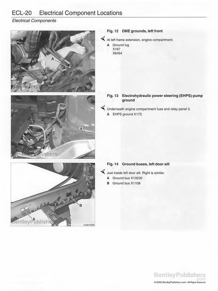

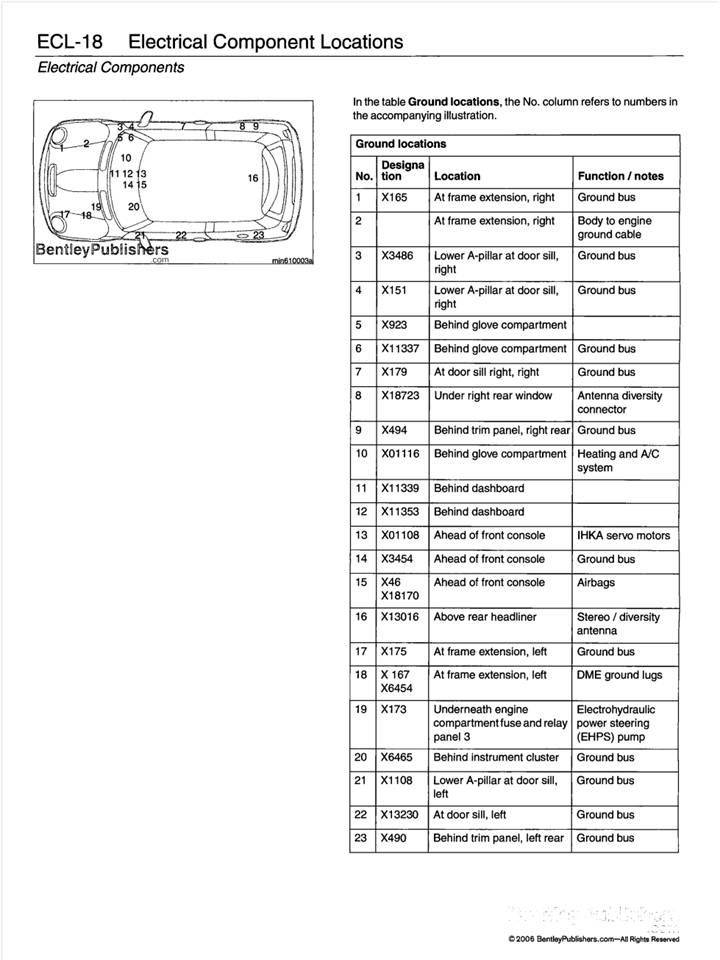

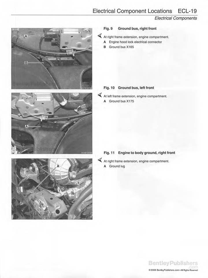

Check your ground locations.
Put the old ECU on and try starting with that.
Thank you for reply. I checked ground connections countless times. Engine is cranking but no still no spark. Any idea about ground location?

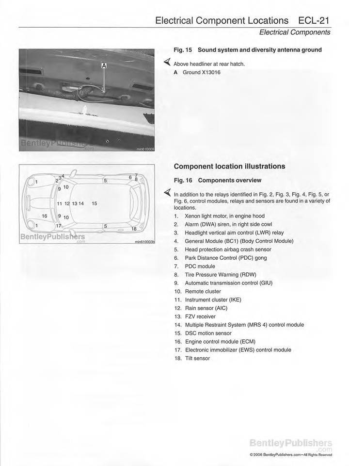

Grounds
