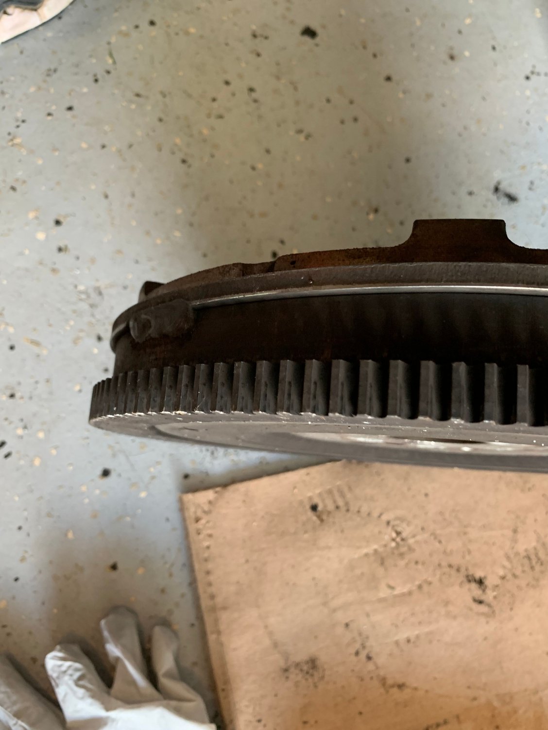

I’m rebuilding my 2011 R56 JCW N14 engine after piston failure. There’s not enough room between my engine stand and block to install the flywheel and then the locking pin. I put the pistons at roughly even before installing the head.
1. Can I go ahead and install the camshafts w/o locking the crank and when I get ready to install the timing chain use the engine lift to install the flywheel/locking pin? Any other thoughts?
2. is my flywheel toast?

Why don't you install the flywheel and be done. You will have to at some point. Do it now
Disregard. I didn't see the pic. Yikes.

Mount it
If the flywheel is good install it. The engine mount goes to the tranny housing and flywheel is inside.

Put the engine on the ground or a bench, then do the flywheel and lock it, then mount the cams / tranny. Don't risk adding cams without locking flywheel. Put the entire drivetrain back in the car as a complete package. Whole lot easier to do timing with engine on a bench or dolly's, and not much fun installing a tranny after engine is installed.
