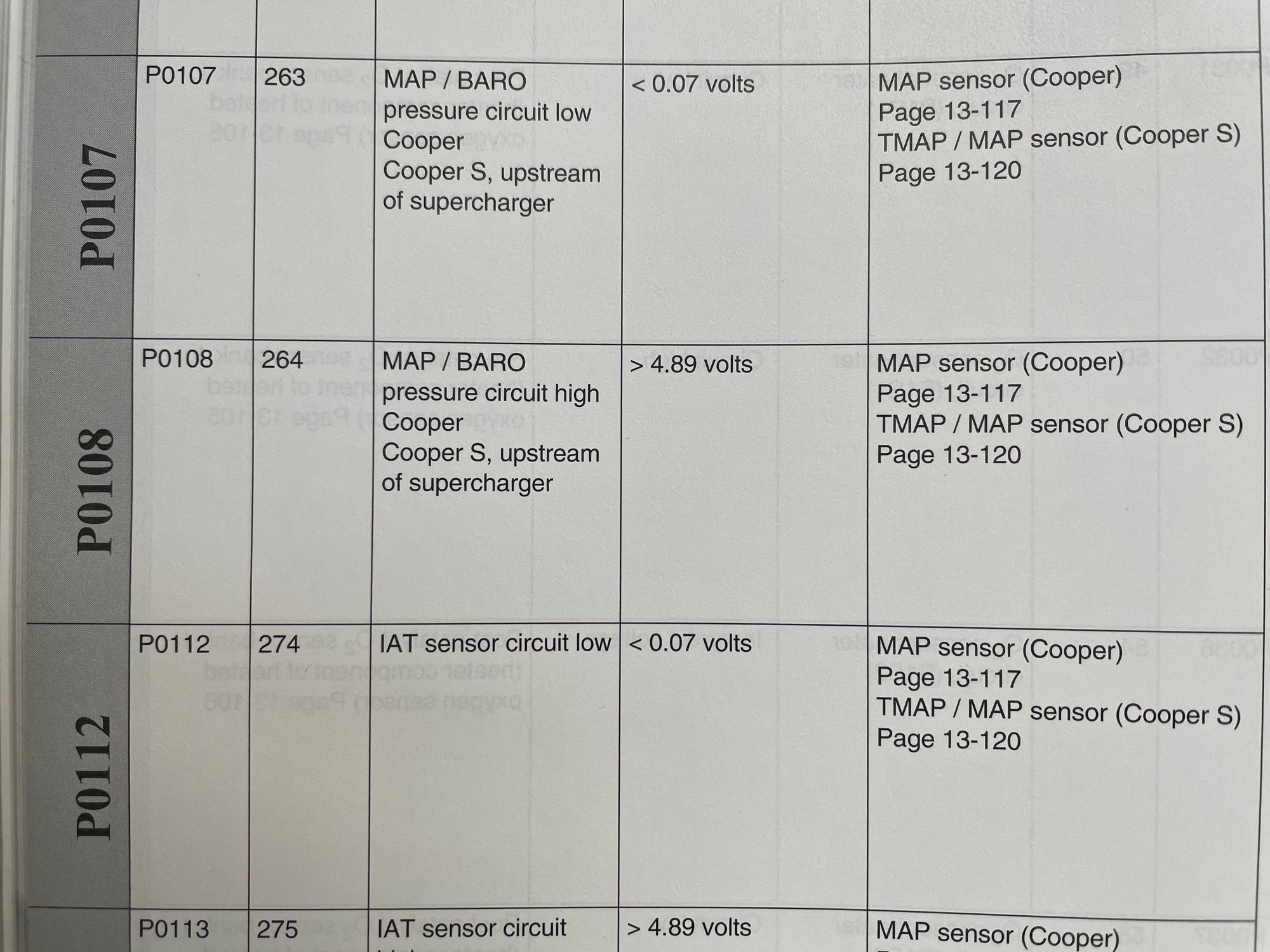

Well heard back from pelican parts and their answer is the basic answer of " our parts department has checked it and the parts number matches the oem " they did arrange a return , but now I am.out the shipping . To be fair the pic on their website it the " continental sensor" but I did not notice they were different until I removed it to swap. I don't understand as I also ordered the 648 map sensor by the intake and it came the same as oem . Looks exactly like my old one and looks exactly like my oem old tmap sensor , but with different serial.on it . I am so confused. I did notice both boxes are bmw oem but the correct sensor said " made in germany" the wrong one sais made in Phillipines on box and " China " on sensor "
Anyhow ordered the tmap from local mini dealership now so there were no issues and what do u know .... " I get the same freaking sensor from Philippines with different bodystyle ! I argued with sales counter and they telling me.its non refundable as its special.order .
Next step i will contact bmw and see what they say,
Input new continental sensor on, go for a run and a p0108 code again . My old oem doesn't throw the code . Now I am.confsed if my old sensor is shot and would not detect the p0108 or is it these darn Philippine sensors which are not compatible . Now starting to wonder if my precat is cooked and causing backpressure and that may be the cause of my super rich fuel trims ?

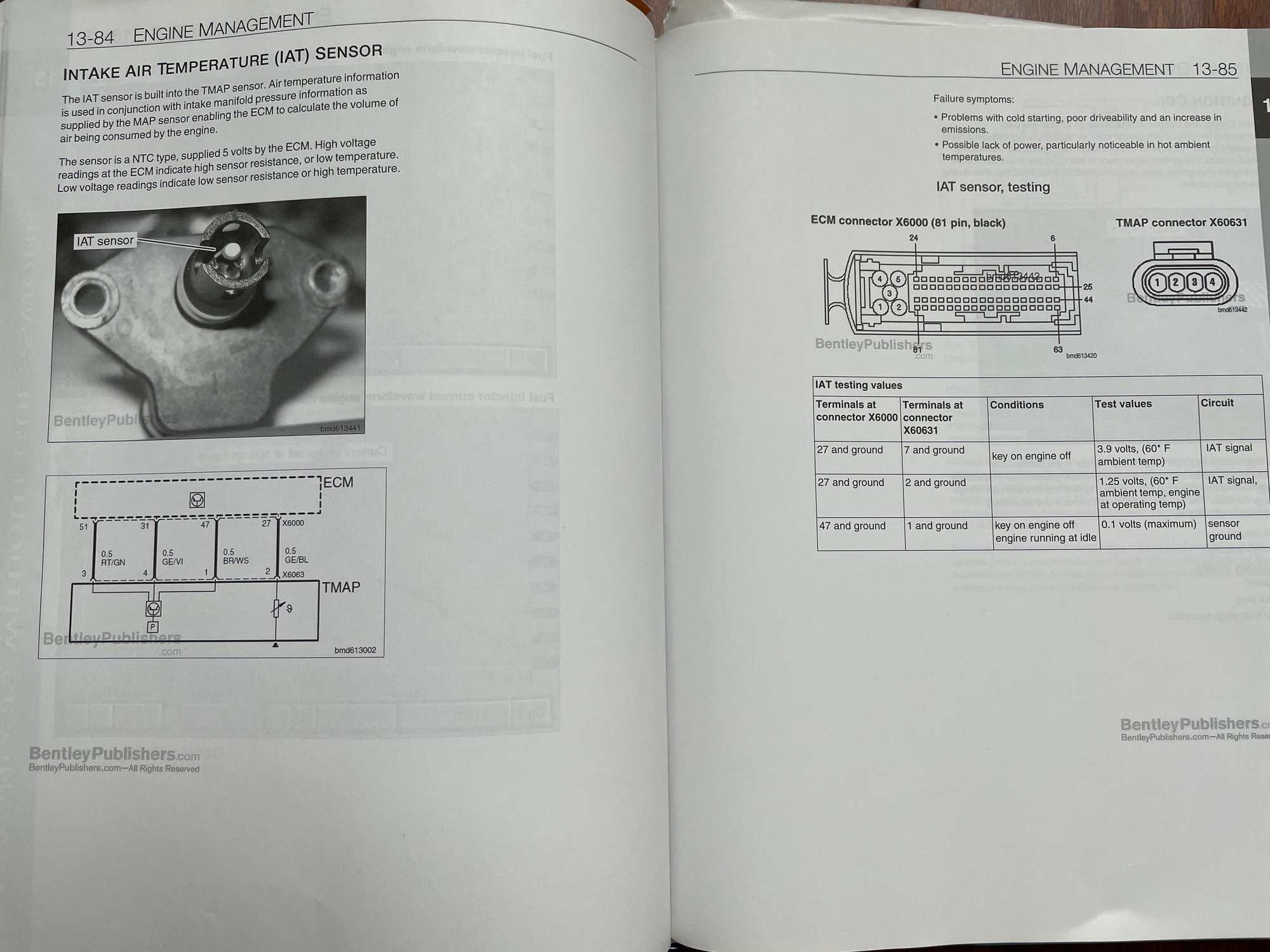

Yes sir. If u received the same part (continental) from the dealer also I’d stop there…
we now have three vendors saying this is the oe part.
also we have a confirmed working case (working in my stock r53 engine).
id start looking for other causes of high manifold pressure. Attached the pinouts. You could test the voltage…
The question is what else can cause high manifold pressure?
