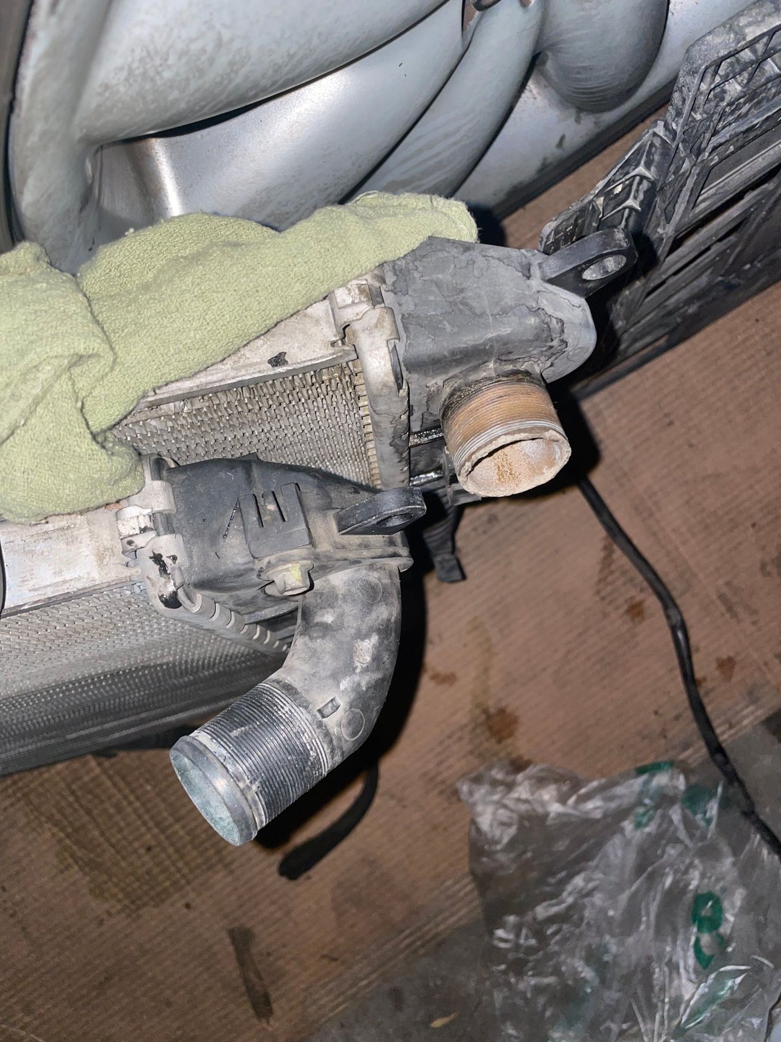

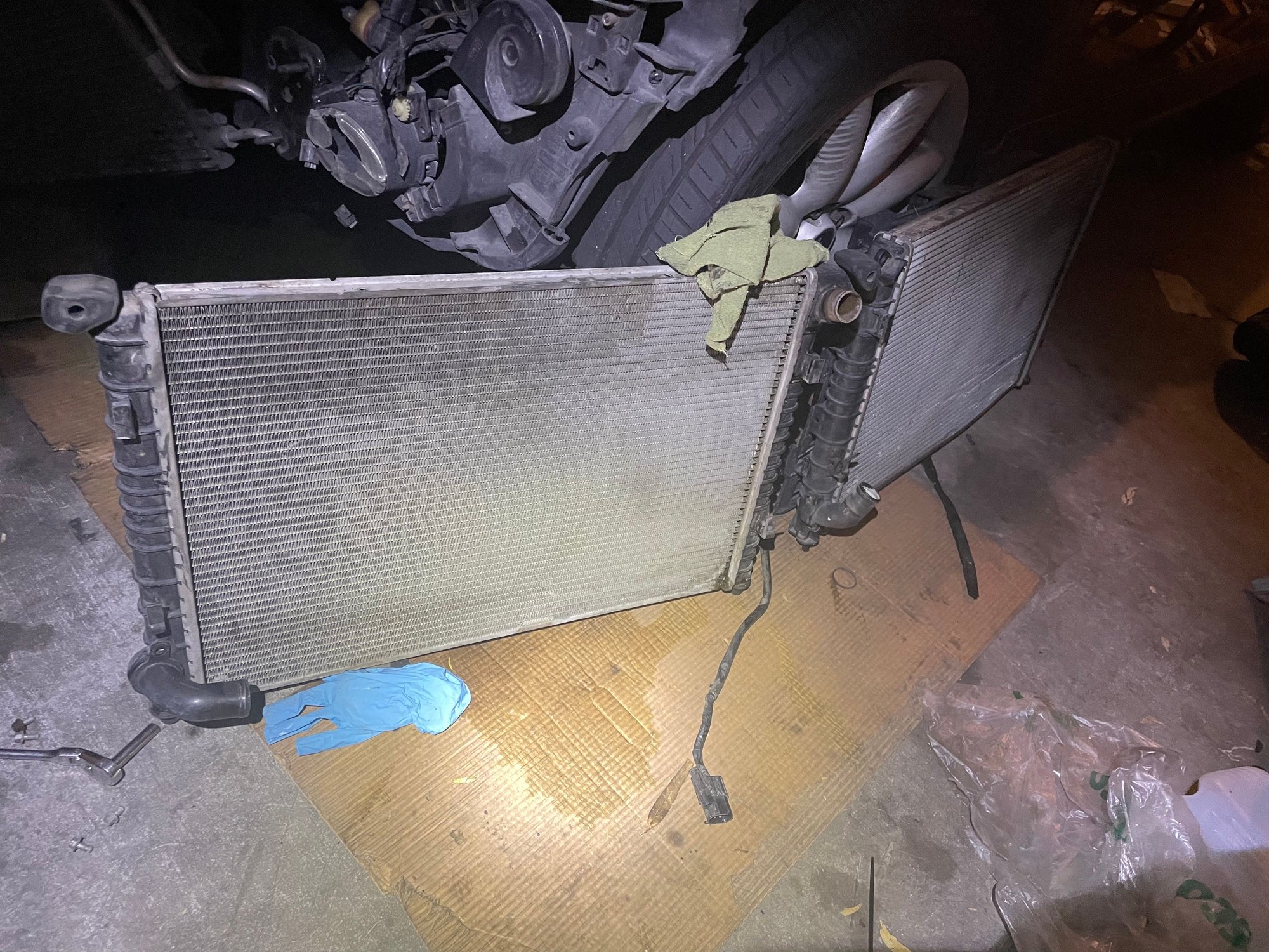

I just wanted to post here and make a record for those who still uses NAM , I know it might sound ghetto that I’m posting this but for those who are on a budget and have a extra radiator laying around that it’s still usable
a r53s radiator does fit on a non s r50 just with minor mods
Mini Cooper non S on left where blue glove is Mini Cooper S/JCW on right

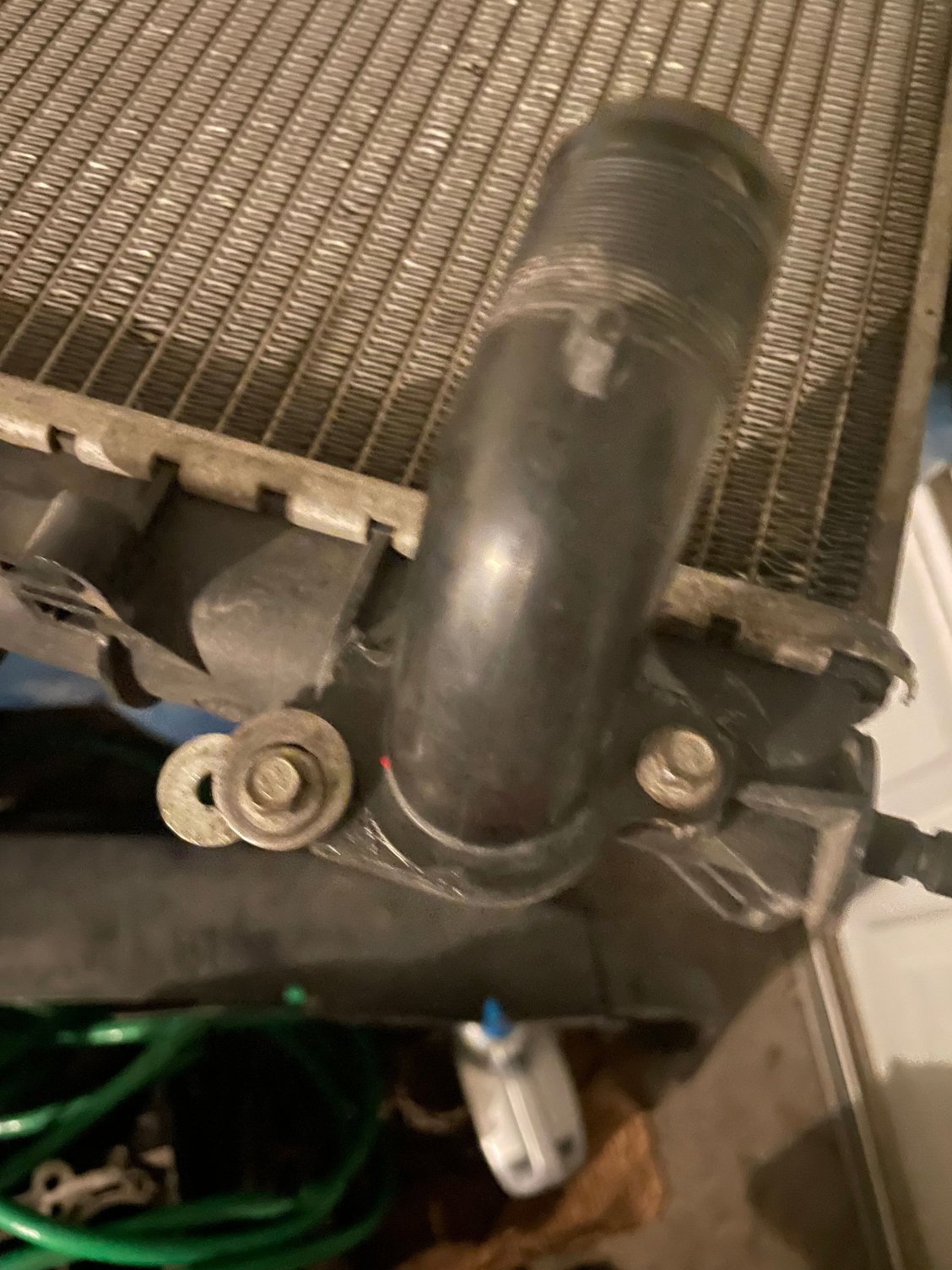

You need to Trim the top elbow to match the r50
You need to take a Dremel to trim top upper radiator elbow to be straight like the r50

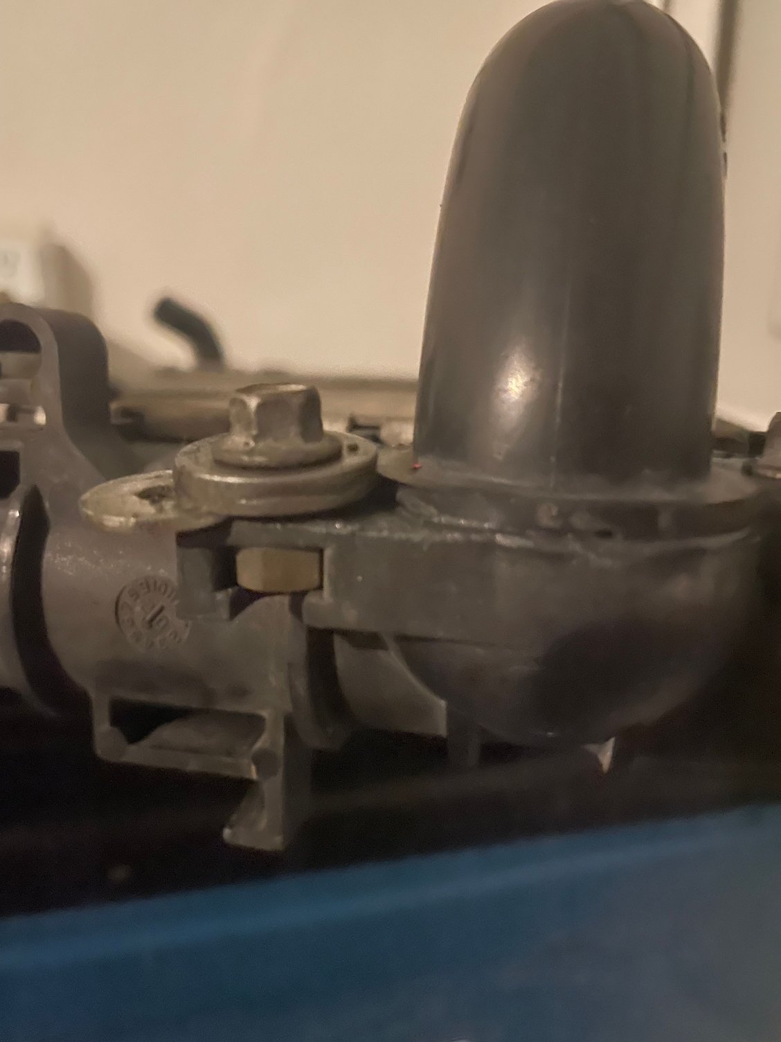

Add some washers to the top hole , RTV the o ring and it works for the temporary it needs
The bottom r50 lower connector is held on by two 8mm and a o ring inside which you take off and just trim to fit
