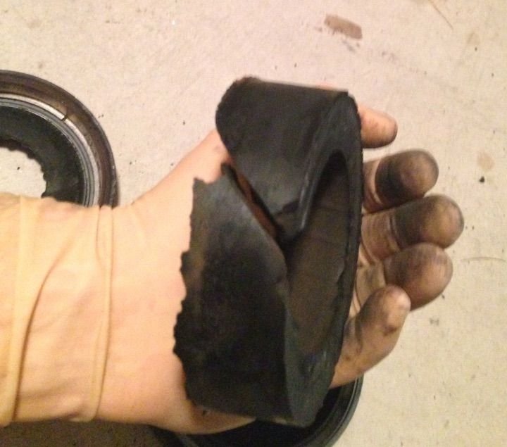

So i pulled of the harmonic balancer, and indeed the rubber was shot.:

Originally Posted by mdurando
...however, of more concern, it appears the inner side of the balancer was rubbing on the engine block: Has anyone seen this before? Not sure if this is just the result of a bad balancer or if it indicates a deeper problem with the drive-shaft.
That damage is consistent with the failure of the harmonic balancer if left to degrade for too long. The rubber separates, the pulley portion wobbles and makes contact with the timing cover. Unless it has worn a hole through the cover, I wouldn't worry about it.
