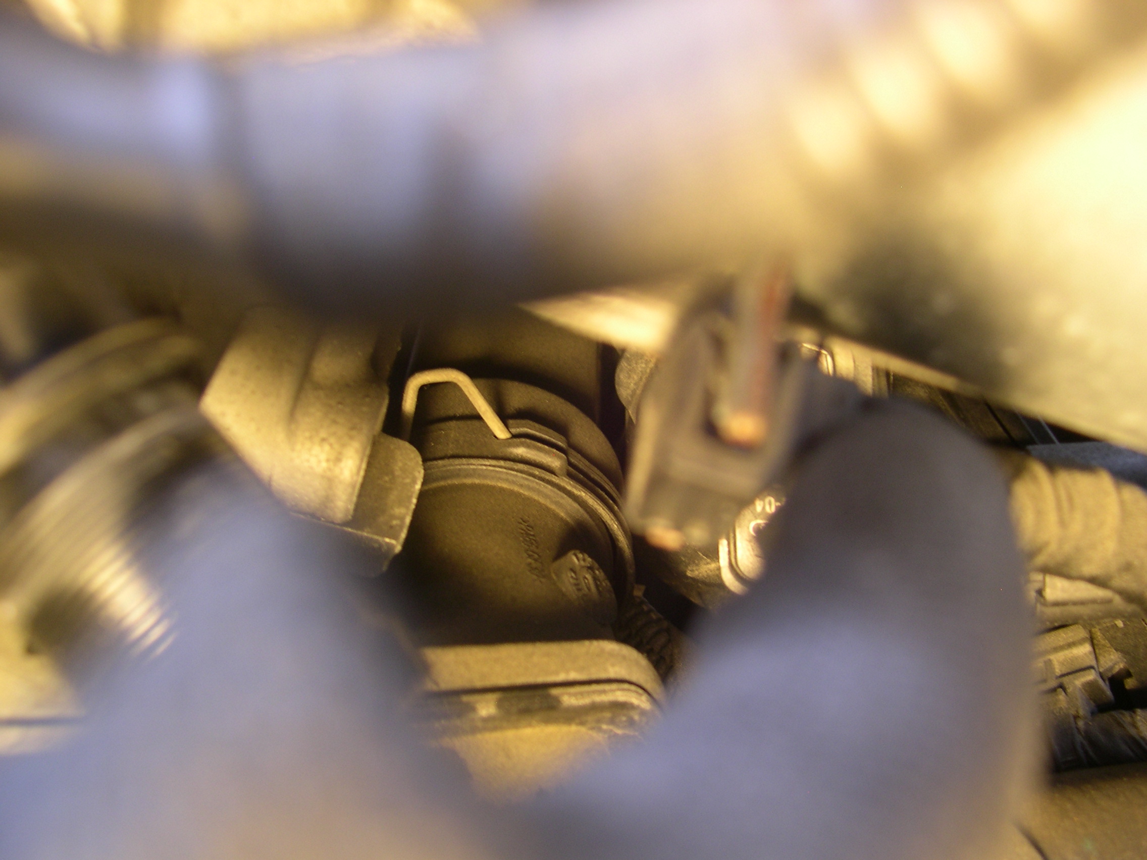

It may help to see the orientation of the clip when properly inserted. I took this photo before pulling it out when I replaced my thermostat. The clip is not straight up and down but leans towards the engine when it is in place. I tied a string to mine before starting cause I knew I would probably drop before I got it in correctly. My hands are small which helped and I used a pair of very long nosed pliers to hold it with one hand and a screwdriver blade to force it down into it's slot. Good luck !
p.s. If I had to do it again I would put a small amount of lubrication on the lower sides of the metal pin to help it along into the slots.
