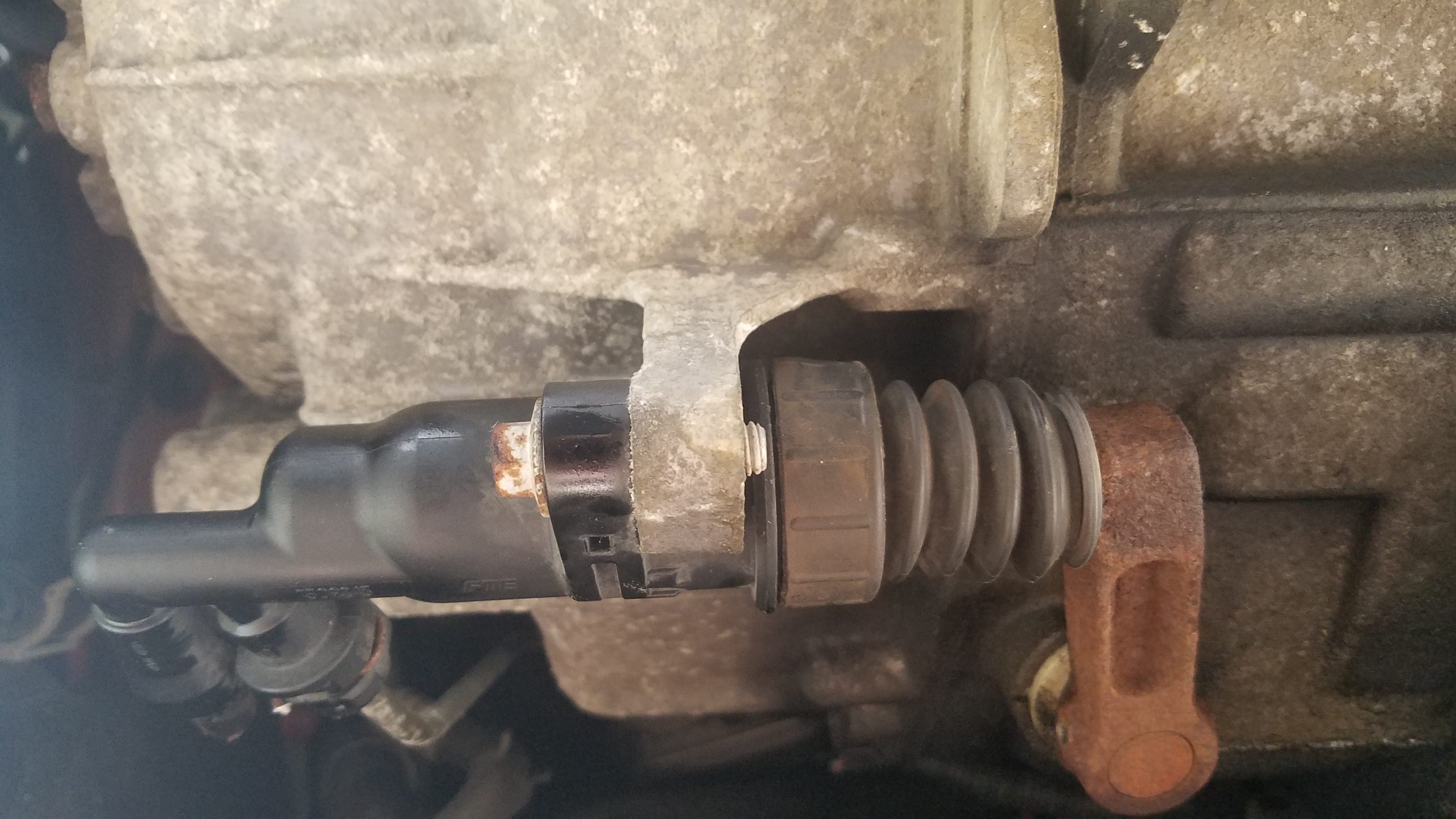

4. Opened shift linkage compartment under the hood and shifted through all six gears and reverse, both cables moved.
5. Checked master and slave cylinder for leaks but both seam to be in good condition.
6. Both master and slave cylinder respond to pressing the clutch pedal but not sure if slave is fully expanding.
7. Slave cylinder can be compressed by hand about 1.5 inches I don't if that is normal.
8. Slave cylinder cannot be expanded by hand

Thank you in advance to everyone for your time and effort. Let me know if you need any more information. I'll add some pictures ASAP.
Attached Thumbnails Shifter Jammed when Engine On-slave-cylinder-resting.jpg   Shifter Jammed when Engine On-slave-cylinder-compressed-by-hand.jpg

I would recommend stopping driving the car until you find out what is going on, we've seen too many cars that have had throw out bearing failure that ends up putting a hole in the trans case.
Pull the boot back on the slave, is there fluid in the boot? If so the slave is failed.
Short of that, I would say you're in for a clutch and some other incidentals.
