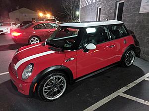

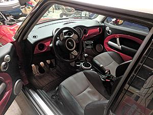

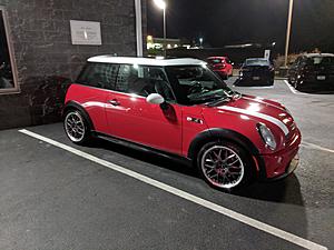

It's actually for sale
My wife just upgraded to a 2011 328i Xdrive So her mini is up for sale. The car has been great to us for the past 13 years and it feels great still. I am a stickler about maintenance and the car shows it. That being said I mistakenly offered a friends and family discount for a private sale and probably underpriced the car because I have 3 people that I know personally lined up to buy the car in less than a day. What would you have asked for this car?
2006 Red with white roof and stripes Mini is going up for Sale, if anyone wants a very well cared for 160K Mile 2006 Mini Cooper S with extensive service records, Newer Tires, Brakes Discs and pads, wheel bearings all with less than 5000 miles on them, clutch, with around 15000 miles on it. I will be selling at Auction and expect to get $3500-4500 based on the extensive service history and overall condition. But friends and family can get it for $3000.
Everything works great on the car
Options beyond standard: Heated seats, Aftermarket Kenwood KDC-BT762HD HD Radio with bluetooth hands free, mic installed on steering column for phone calls and A2DP
