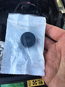

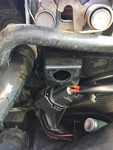

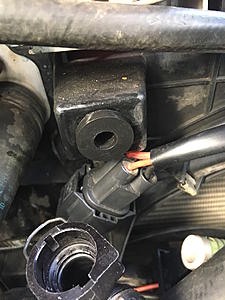

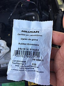

3. When installing the expansion tank, I found that the rubber grommet was missing. I didn't want to order a new one. I went to Lowe's and found a grommet ($1.5) that would fit. So, I used that instead of buying an OEM grommet. Hope this helps. See the pictures.
