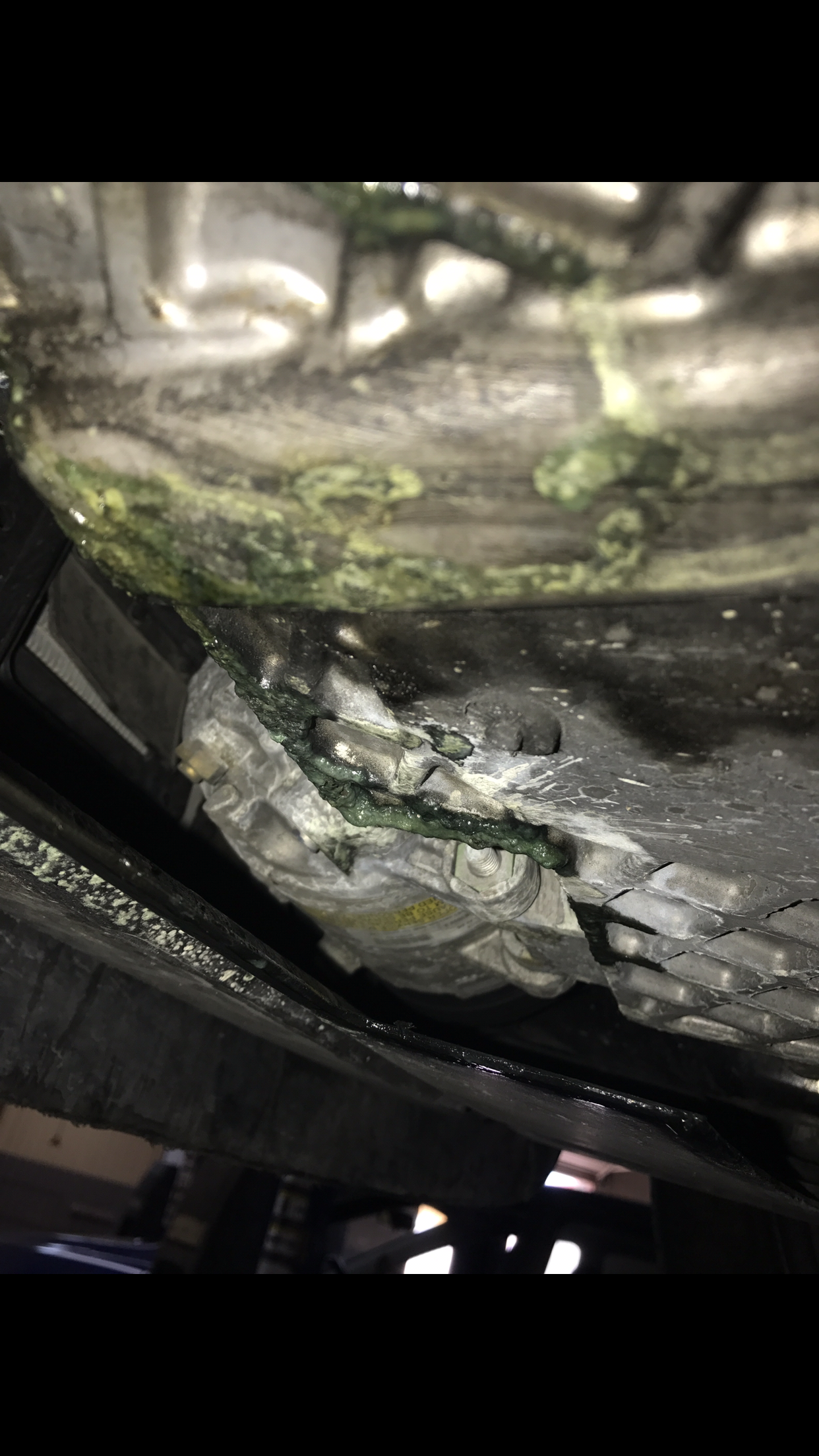

Last post would not allow me upload pictures to it. Very odd. So here is the second attempt.
I have a coolant leak running all down the front side of the engine. Looks to start at the thermostat gasket, but there is some above it as well. Just a little.
(2008 r52 JCW)

Lots of coolant hoses in that area with the t-stat and waterpump right next to each other.
Most likely time for front service mode

That's exactly what I'm thinkin. Just watched Mod MINI's video on it. other than that, shes COMPLETELY dry on the undercarriage..
