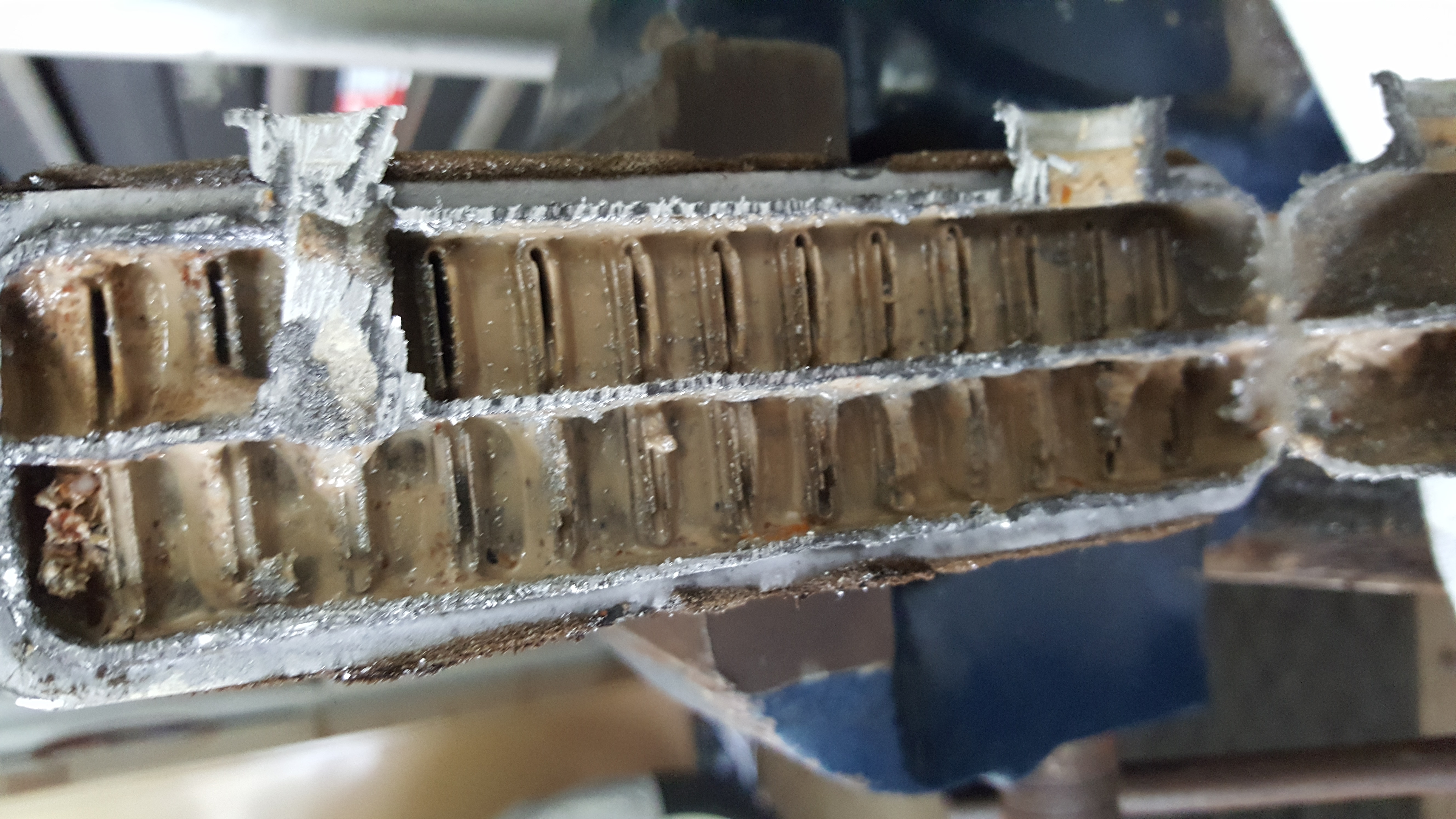

Just did our heater core due to it being plugged. I never noticed a temp spike but had very LTD heat and coolant occasionally was being pushed out of the expansion tank, more than likely due to loss of flow through the core. I can report after the replacing the core we have a lot of good heat and no more coolant coming out of the surge tank. I cut open the old core and it was quite odiously plugged. One thing I did while bleeding the system was squeeze the upper rad hose 10 or so times while running thermostat open to aid in the removal of any air locks. No coolant valve exists that I'm aware of. Just pump and thermostat. If you remove the side panel by the accelerator you will see the heater core and related pipes. If one is hot and the other cold good chance you will be doing the core. Fairly easy job. I found a suitable pan removed the accelerator pedal and punched a small hole in the bottom of the core for a controlled drain rather than soaking the carpets and smelling coolant for the next year or so. Hope that helps and keep us updated.

I had some time so I thought I would cut it open. And here's what I found.
