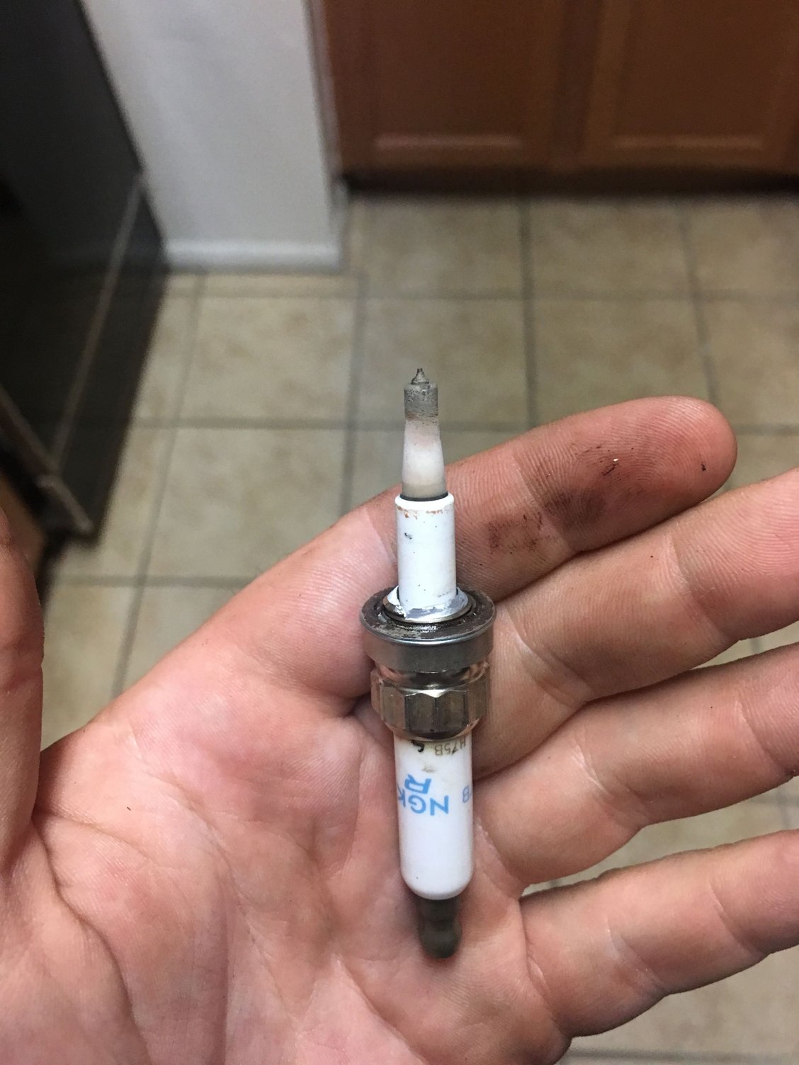

**Separate Q - when was the last time spark plugs were pulled/inspected/torqued? You can tell whats going on in the combustion chamber pretty well by looking at the plugs for each cylinder. If you find wet plugs..or if there is buildup, the color of the buildup.. the orientation of the buildup.. these all let you know whats occurring.
