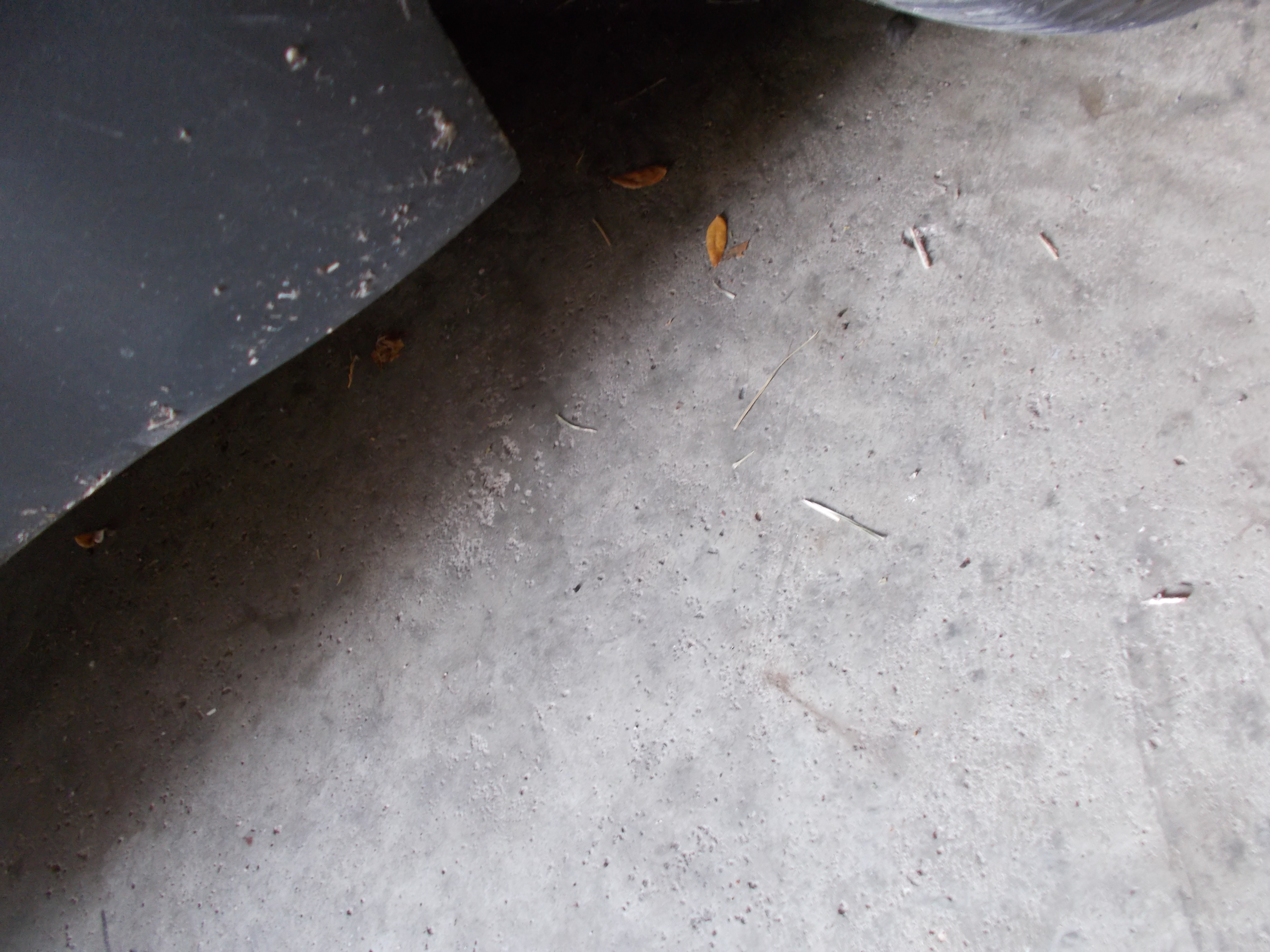

From full to this level in 2 days, and no sign of fluid on the garage floor. Unless I could drive around with the wheel liner off, I'm not seeing any sign of leakage.

It is a long shot, but I'll mention what happened to me. I found that under hard braking (not sure how hard is hard enough to cause this) the fluid would be thrown forward and splash out of the top even with the cover on. One time, it actually pushed the cover open so I zip tied it closed. Any chance this could be the issue?

Is it leaking in the rear trunk, and filling tool/jack area?
Old Sep 27, 2017 | 07:45 AM
Posts: 36,766
Likes: 2,553
Could be splashing into the engine bay under hard braking. If that cap pops off. When mine leaked on the bottom from the pump it was on the garage floor.
Make sure the line is not leaking into the trunk near the rear wiper motor.
