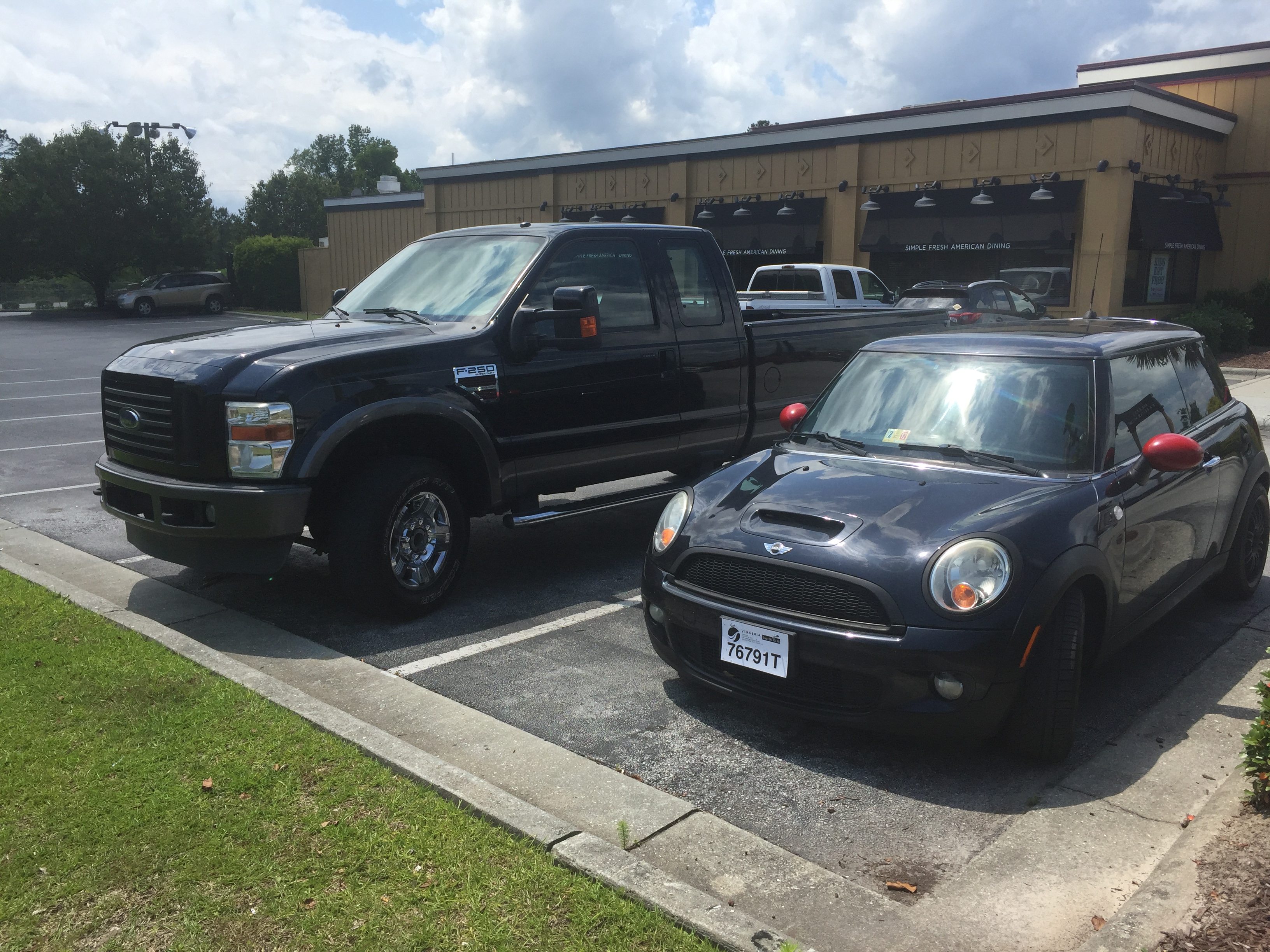

Hello All!!
To start with, we have a 2009 Mini Cooper S 6 speed. It has been pretty decent in the year and a half we have had it. We went through the work timing chain tensioner issue and other then that have had just normal wear item issues.
Now we have a new problem. My wife drives this mostly when she doesn't want to drive her X5. So I don't always find out about issues until there is a small list. The issue started as a small braking issue. It usually happened around slow speeds i.e. pulling into/out of drive way or parking spaces. You would apply the brake and the brake would be hard and the car would still roll until you pressed the brake harder, but then still not usual stopping power. The second issue related to this is the trans started getting harder to shift in and out of gear. It acts as if the clutch is not being engaged all the way. It finally got so bad the car would not start due to not engaging the neutral safety switch.
I live in a small town and work with what I have. That said, they said they think the flexplate is bad and needs replaced. They think the braking issue is totally separate. They quoted $1,900-3,900 to fix the trans issue. They said it depends on what all they have to do while in there. They bypassed the neutral safety switch to we could bring the car home as I am not 100% sold on both that being the issue or wanting to pay them that much to fix it if it is the problem.
I feel the braking and clutch issue are somehow related. Can anyone help me here?
Thanks and sorry for the long post, I wanted to give as much info as possible.
TL;DR - hard to shift, clutch won't engage neutral safety and brakes not working right at a slow roll. Help! LOL
