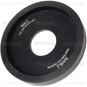

I wasn't even questioning whether to replace it. It's right there with the flywheel off so why not. But then I started reading that people have had problems with replaced seals. Hence my post.
To help get it installed properly I've been thinking I would 3d Print an install tool to give me something to tap on while pushing it into place. I've watched Mod Mini install one on YouTube when he was changing out a clutch and he talked about using a soft hammer. A ring that is about 1/2" thick and the exact size of the seal could help spread the force when tapping it in. Perhaps I'm over thinking or over worrying about installing this component.
Attached is an image of what I was thinking of making. This is a random tool I found while searching, not an existing Mini tool.

Appears to be a very good idea.
