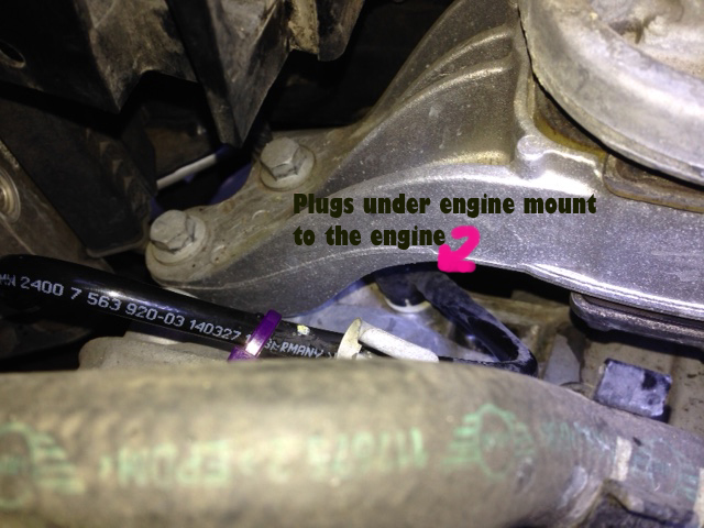

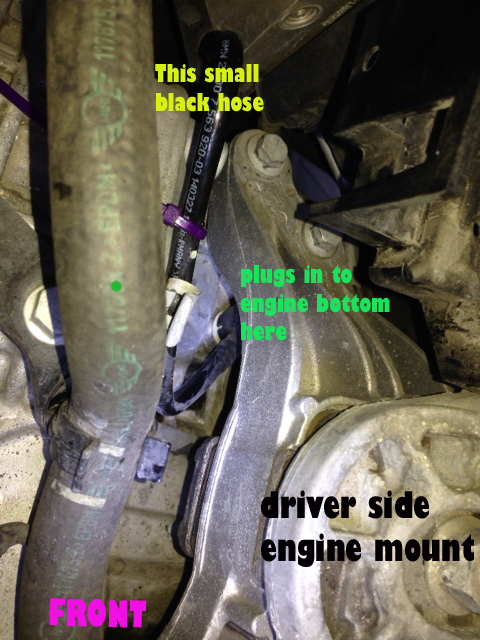

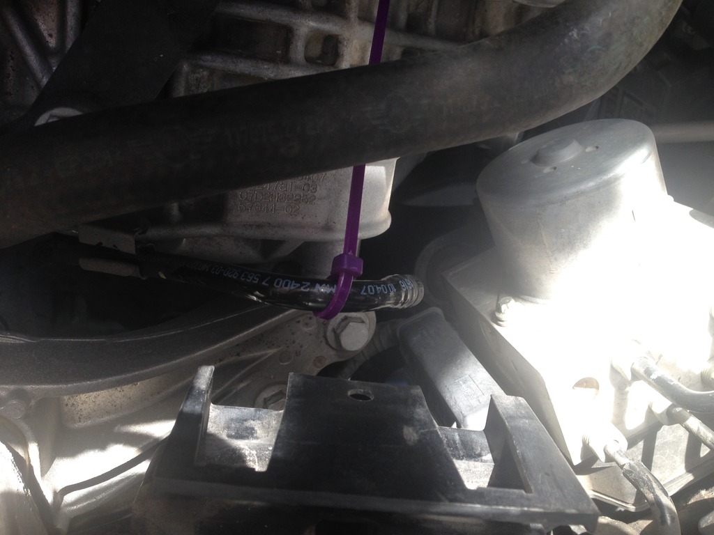

I just got my first car, a 2007 S hatchback. I love it!! A week after buying it I got the dreaded half power light as its called. My dad googled it and said no one really is sure what causes that light. We live in the desert in california, so its hot out here. My dad thought that the car is running hot due to the fan always coming on So he was going to put in a new thermostat thing. While he was stripping down the engine he noticed a small black plastic hard hose that wasn't connected to anything. So I'm just typing the things he's saying. The hose is under the driver side engine mount. It connects to the bottom of the motor under the motor mount. The hose clips to the side of the motor with a silver clip. He thought it might be a breather hose, but the end of the hose looks like it was connected to something. I took some pictures. I put a purple zip tie on it.

Dad is correct about the hose being the transmission breather. It looks normal.
Since this is the first time dad tears the engine and gets inside, I suggest cleaning the turbo inlet and outlet and do inspection later in the week to see if there is water. Since the weather is hot and maybe humid, there is a chance that there is condensation in the turbo inlet.

Remove the zip tie from the vent pipe ASAP! Go to the link below and make sure your vent pipe looks the same, if not buy a new vent pipe. Treat your $6000 transmission with care and respect....
