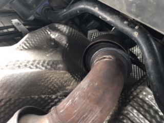

Hi All,
Thanks for all the replies and suggestions. I finally got a chance to get under the car and take a look of the header. it broke apart badly. dunno if this is can be welded back; going to check with my local muffler shop. picture attached

Old May 15, 2017 | 11:49 AM
xsmini's Avatar
xsmini
Joined: Jul 2002
Posts: 2,228
Likes: 28
From: Bishop, Ca
That can be welded, mine broke there once too....

It would be regular argon blend and mild wire, but I would weld that for you if you were in this neck of the woods.

I spoke with my local muffler shop. He is ready to do the whole thing, taking out the header welding and put it back for $200
or if I bring him the broken header, he will weld it for $45
how hard is pulling it out and putting it back on?
is it worth doing the pulling out and install work myself to save $155 ? I have done similar work on a 4 cyl bmw long time ago and it was a pain to put it back as I remember.

If you were going to install a different header yourself anyway, I'd say to save the $155.... But I tend to be cheap.

Update:
I went ahead and pulled the broken header from the car over the weekend. It was a piece of cake. I was done with the work in less than an hour . That includes jacking up the car, removing the oxygen sensors and the cleanup etc
Will keep this thread updated when I get the header from the shop after the weld
