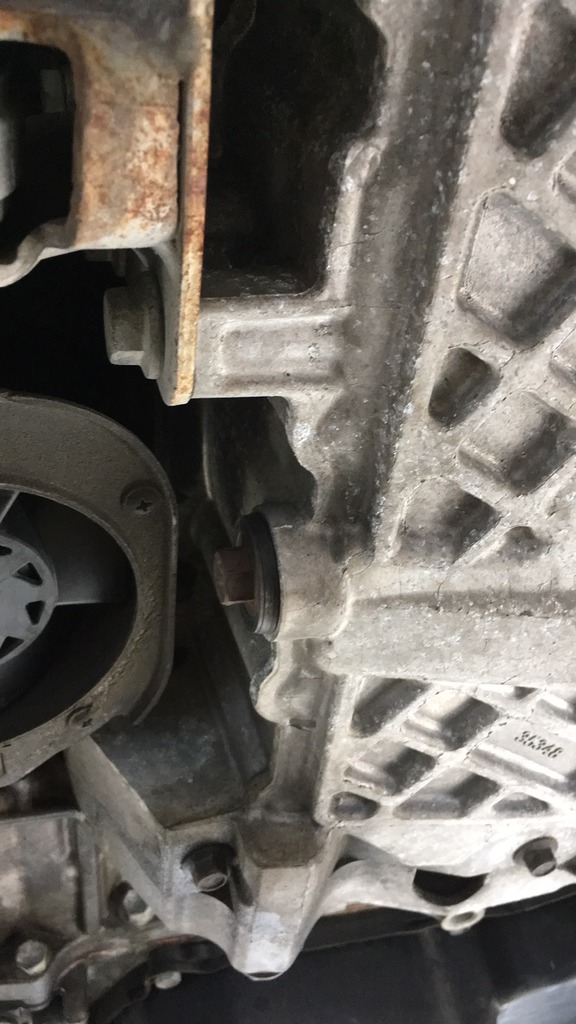

Finally after years of wrenching in the driveway it happened. I botched an oil change on my 2-month old new to me 06 MCS automagic.
I went to get this drain plug off, left loosey right tighty I know, and stripped the head of the bolt. I used the recommended 13mm socket and it rounded right of. Tried channel locks with no luck, just more material coming off.
Hammered some smaller sockets on there as a final attempt and it was a no go. It looks much more round than when I took this pic. It was after the first pass.

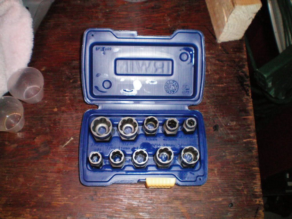

You should be able to find these and get the bung out without drilling .... they've never failed me ... extractors that go OVER the head ... you pound them down as you tried but a made to 'cut in'. These are made by IRWIN and I got them at an auto-part store (many years ago)
