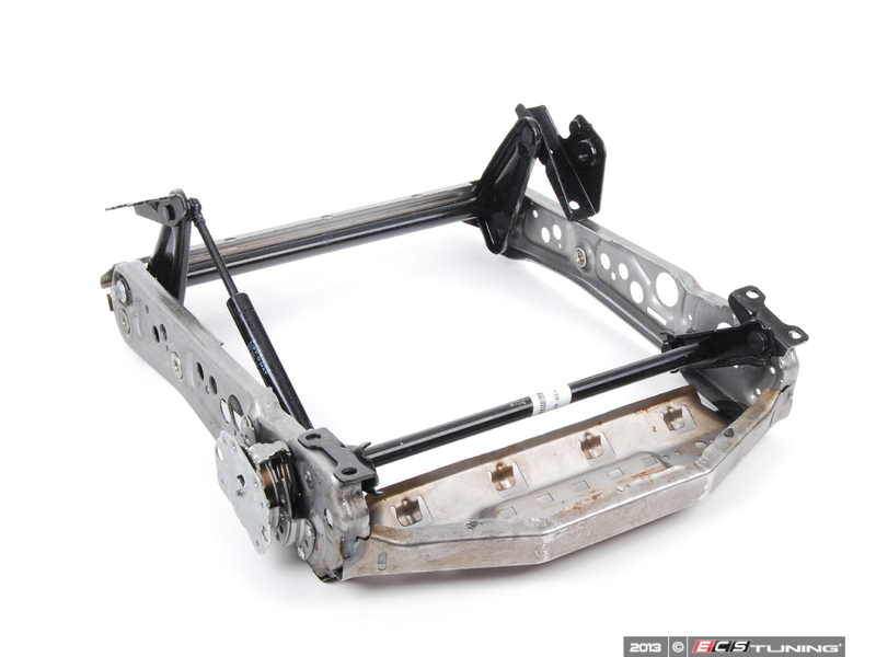

Chek the little strut and the mechanism, yes and watch that seat, if you take it out and have to unplug it make sure the car battery is unplugged.
I would swap the strut first:
One per seat 52107069970

That's called the gas spring for the seat vertical adjustment? they go bad am assuming I will check it out...Thank you

Yes, that's what it's called. They can.
