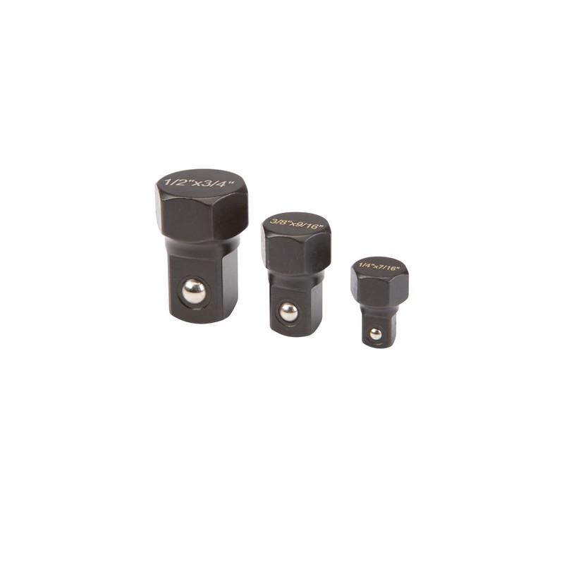

Also, I've found that using a socket and a socket cap with a ratchet wrench works really well for getting in between the tensioner and the frame.
Socket Caps:
