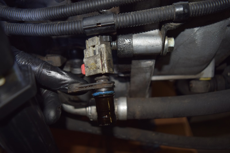

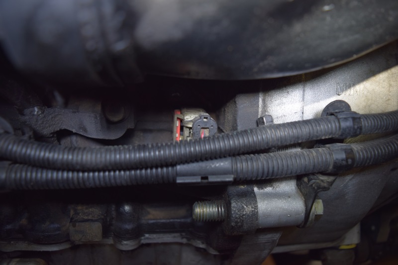

Crankshaft position sensor.

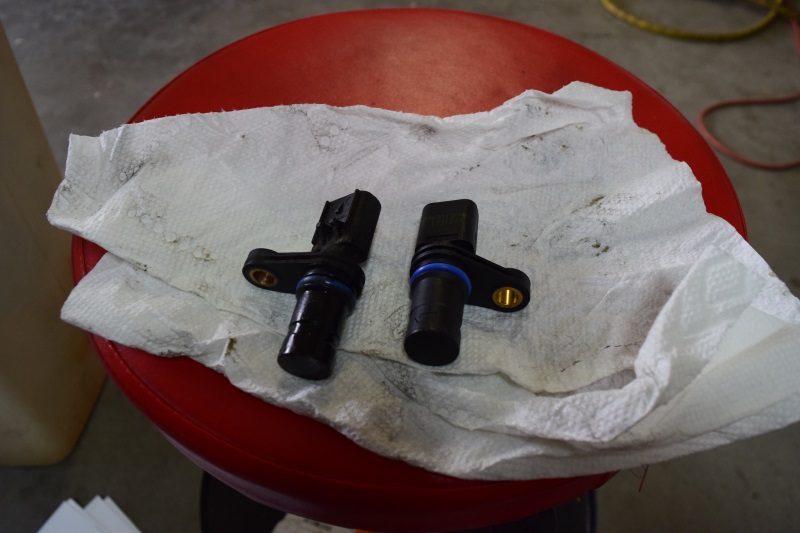

I replaced the entire sensor (elective) at 115k miles on my ’05. My other sensor (Camshaft position sensor) died (check engine light) at 114k miles so I was not taking any chances while the car was apart.
Front of the motor underneath the supercharger
Removed
Hole in the block that it plugs into. 10mm smaller bolt secures it to the block
New vs old
Removed
New vs old
