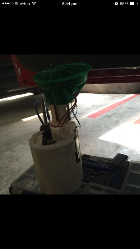

High pressure fuel pump-image-1054098070.jpg I have modify and upgrade the in tank fuel pump to 300LPH hopefully this will prolong the HPFP.
