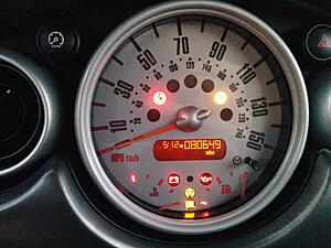

I have a strange problem with my 2006 Cooper S. The airbag light won't turn on with the rest of the cluster lights when the key is turned to the second aux position.

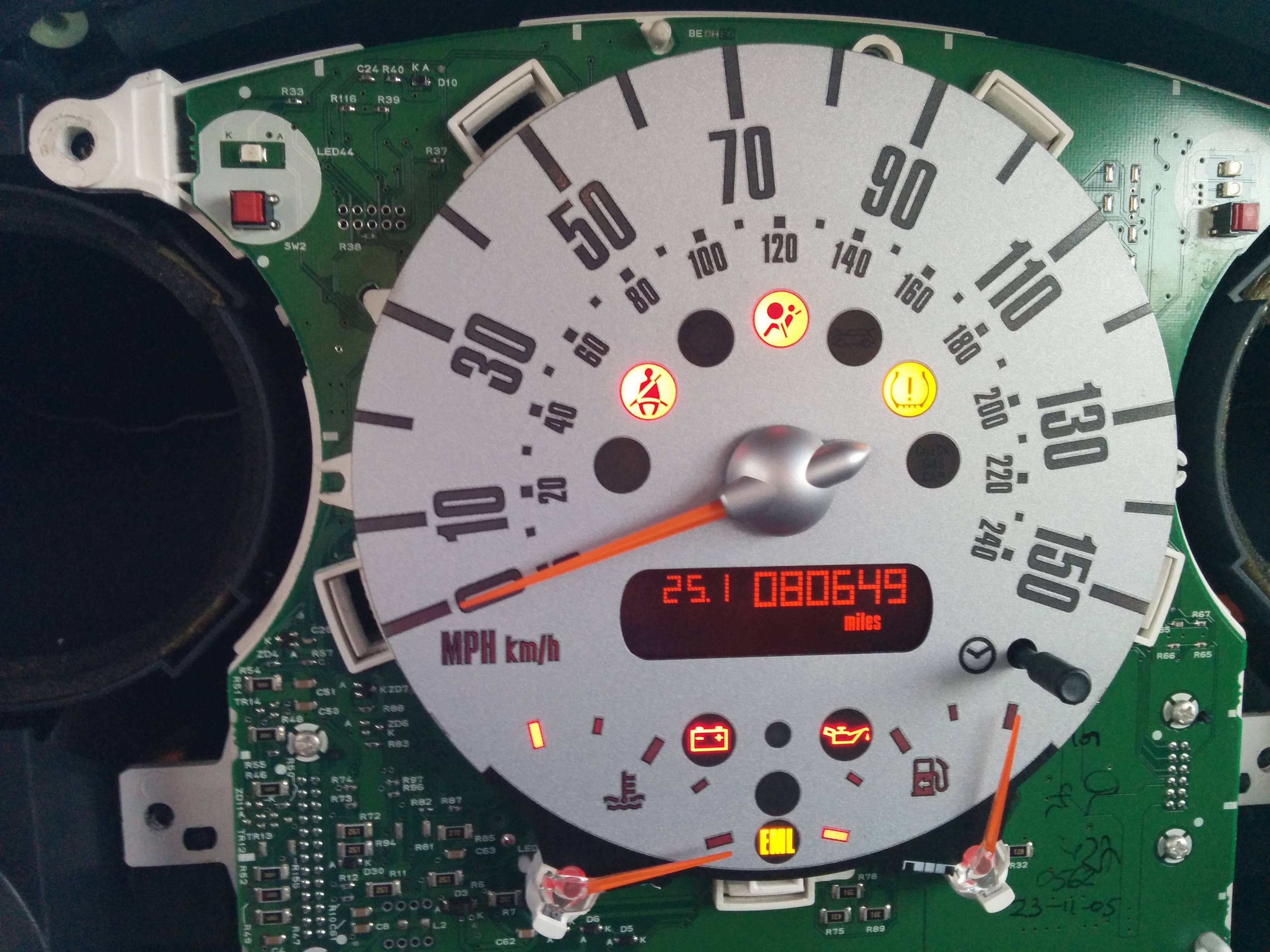

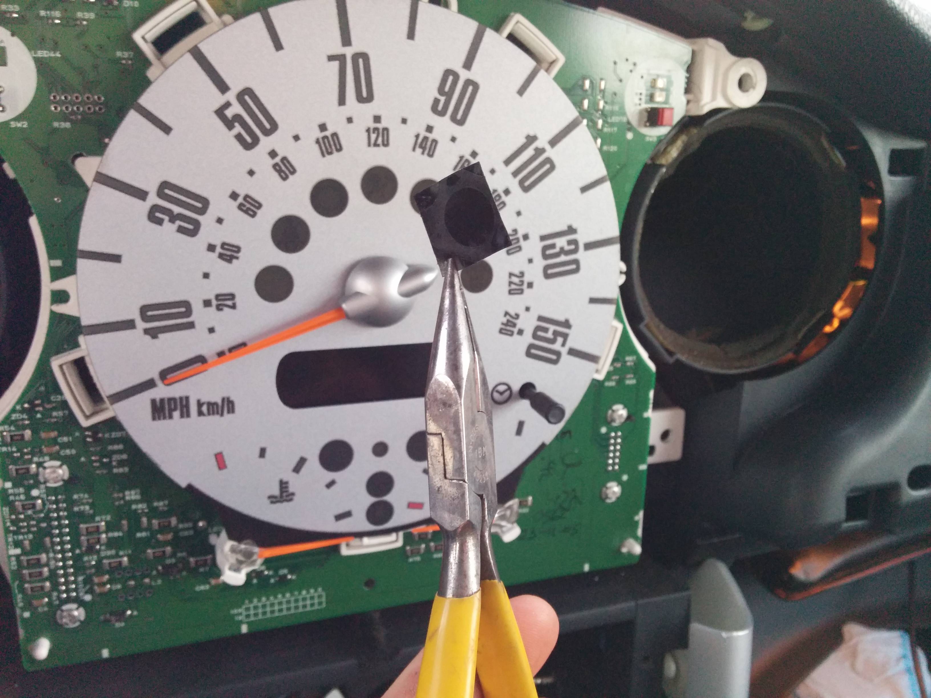

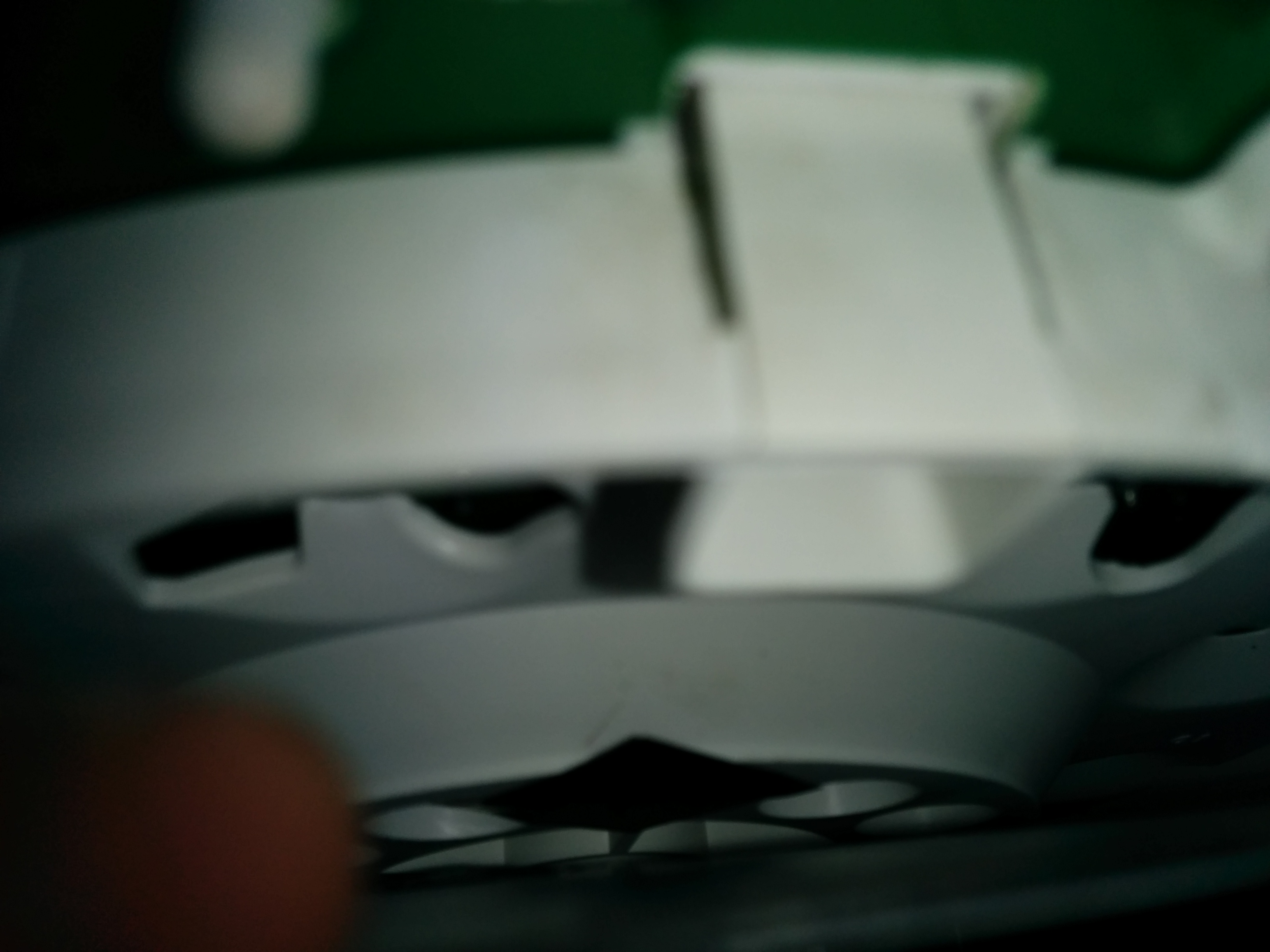

Double checked the manual today, it said the airbag light should illuminate when the key is in the first position. Crap.
Decided to pull the cluster apart to confirm my suspicions, and well the pictures tell the rest.
Stinking electrical tape covering the airbag bulb. Now to get codes pulled and figure out what's wrong with the airbags. Hopefully it has something to do with the seat pad sensor recall.
Moral of the story, don't trust used car dealerships.
