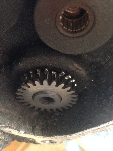

I have an 06 r53 with only 40,000 miles.Never dreamed that the dang charger was out of oil and ate the water pump drive gears.
Does this require a whole supercharger or just the end gears and bearing? Thanks. Jim

Rear gear sets are available for purchase as is the rear needle. The seal behind the gear on the slave rotor is the culprit. I have replaced several of these seals and I have yet to find a shaft that is not usable. The seals are a few bucks but you will need to fashion a puller to remove the gear. All in all you will spend $300 to fix with new gears so only you can decide if it makes sense to go the extra and replace the entire unit.

Well a little update. I have ordered new gears from a gear supplier in the UK. It's ridiculous what the cost the suppliers want for these two gears. 275 for them is robbery.I am a machinist so it was a no brainer as to what I was going to do.
I bought off the self stock gear blanks.Its sad that I couldn't find any in the US tho...total cost with shipping is 57 dollars. I am replacing everything in there.New shaft,drive coupling, bearings ,seals ,water pump, thermostat and housing.Crank position sensor oring.
After all that I'm at the cost of what just the gears were going to cost.
I have came up with a way to check and fill the oil level on this now.It is what mini should have done from the get go.Ill post pics when I get it all together. It's so simple it's ridicules.I will be able to check the oil as fast as you check your engine oil.Also can add that fast!no more dry gears!! Jim

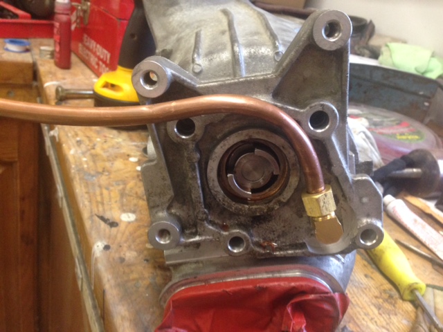

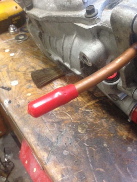

Heres. The pics. Will need to trim tube to length once it's on and I see the room between the radiator and stuff.

did you set one up for the snout side too?
Old Nov 29, 2014 | 10:49 AM
lathedog's Avatar
lathedog
Joined: Aug 2010
Posts: 213
No I didn't . I don't see where that end has any problem and it may be able to check it on car.
Got it all back together. Here is my finished product. Just pull cap Off and the measuring stick is in there. Makes it soooo easy now too check and add.

The "supercharger recharger" (I own one, but is not currently installed on this engine incarnation) is similar in concept, but is more of a hydraulic setup and exits by the airbox.
How does the measuring stick work do you have a marking system on it for the volume?
Did you need to increase the volume of fluid to compensate for the tube?
How do you put more fluid in? The other product uses a vacuum to suck it into the gear chamber.
Old Dec 1, 2014 | 09:01 AM
lathedog's Avatar
lathedog
Joined: Aug 2010
Posts: 213
Thanks again.
The fitting I'd is the same level as the original plug. I added extra oil because I can lol I have about a qtr. inch extra oil in it than factory. The tube is above fitting really and doesn't come into at as far as volumn. I used a piece of weed eater plastici e for a dip stick. I just push it in and it bottoms out. If it is full it will be on the tip.if it doesn't show then you would need to add a little
Bit at a time. It only holds a few tablespoons worth. Ridiculous I think.i can stick my vacumn hand pump hose down the tube to suck out if it's too full but it won't be able to change fluid.the rest is in the cavity in the case.
I added a piece of gas line to the end of the copper tube after I thought about the engine moving when driving. It will give it flex between the engine and core support
