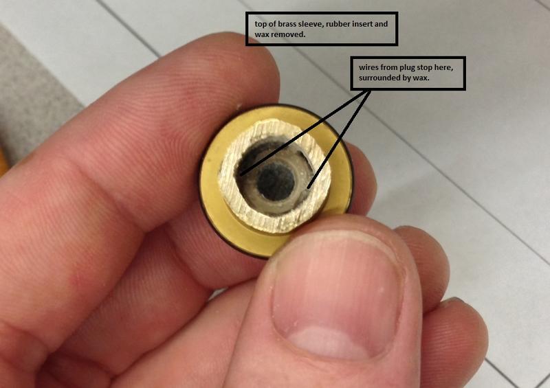

I replaced my thermostat a while ago, as it seemed to be stuck at least part way open (car wouldnt come up to temp), so I took it apart today. The brass sleeve is molded into the thermostat housing and is stationary and has a rubber insert surrounded by wax. The metal plunger has a spike in the center that lets it slide back and forth over the brass sleeve to open and close the thermostat.
The interesting part is the wire leads (from the electrical plug), not entirely sure, but I'm wondering if they act as a heating element and melt the wax when the car gets up to temp, forcing the metal plunger to slide and open/close. If this is the case, I cant figure out what would have caused mine stopped working.
Thoughts?
Attached Thumbnails Inside the R56 thermostat-img_0730.jpg   Inside the R56 thermostat-img_0746.jpg   Inside the R56 thermostat-img_0750.jpg

Could it be a sensor rather than an actuator? It would tell the DME on the t-stats heating/cooling cycle. IIRC OBDII cars need to know when they over cool for too long for emissions reasons.
Without a heating element, and high-current wires I can't picture it really being a heater.

There *is* such a thing as a wax motor. It uses a heater to expand wax to move something. My old Triumph TR7 had one as part of the auto-choke functionality on the carbs.
http://en.wikipedia.org/wiki/Wax_motor
Not sure if that's what this is in the thermostat, but it's a possibility at least.

You are correct. They use that heating element to help open the thermostat. That is how MINI was able to vary coolant temps with sport button on the later N18's and how Manic is able to change the target coolant temps on their tunes. The ecu also monitors that heating element and it causes a check engine light when it goes bad.

Lol, just came here to post the same after some digging. I guess this could help explain the rapid cooling in sport mode.
Some good info here - http://www.bimmerfest.com/forums/sho...d.php?t=508605

Interesting, an electric version of the original wax and spring thermostat.
Wonder what caused mine to fail. The car wouldnt come up to temp, just stayed around 180-190 most of the time, only getting up to temp when it was 95+ degrees outside. But once it got up to the 218-220F mark, I could turn the HVAC fan up to high and the temp would drop like it should.
In fact, this morning, with a new thermostat, I noticed it only got up to about 205, but no higher, it was in the low 70s outside. Not sure what could cause the car not to get up to temp if not the thermostat.
