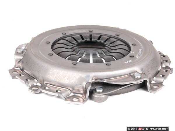

Has anyone suffered a flattened or collapsed pressure plate? What were the symptoms? I took my R53 JCW to a reputable local shop and they think I have this problem. The estimate to R/R the clutch/pressure plate is $2500 so I'm wondering if they're just shooting in the dark. They're not especially experienced in MINI's but do work on BMW's and all other European cars.

The pressure plate & usually the throw out bearing over a long long time wears into the fingers of the pressure plate, you will sometimes here the rattle of the throw out bearing on the fingers. Have not seen to many collapsed. they will have to pull it to see whats going on in there. Hope the fork is not split or something internal, near the clutch plate.
You can do a Dual mass to single mass conversion from Valeo. Saves you money on the dual mass flywheel.
