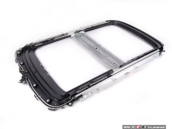

Sorry I missed your last post. Yea the cables are not a separate part. They looks to come in the new frame part so you don't have to whole unit with the glass. Did the cable snap?
#1 above without the glass. 54102758294
http://www.ecstuning.com/Search/SiteSearch/54102758294/
Here is a link to the R56 Sunroof high temp repair.
Click on the links Page 9684+ these will give you the grease points and spots to look at. .
