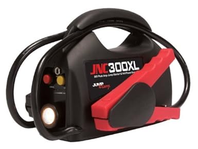

I also carry one of these so I can jump myself. Just in case or others!
