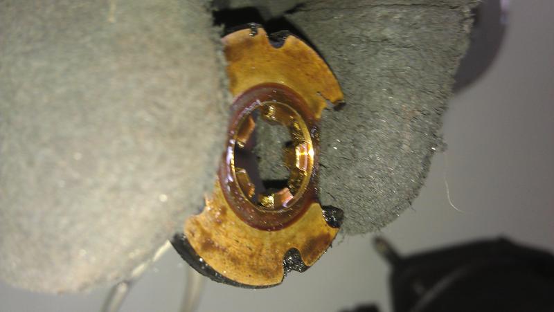

We get this information from our customers. We try to find out as much information about what caused the problems before we recommend a solution. The majority of turbocharger failures on these cars happened between 40 and 50k miles. The problem is that most people don’t realize it because the emissions system works so well. Gone are the days of the tell tell sign of smoke from the exhaust letting you know that the rear pressure seal has failed. Instead we are left with almost no clues that the turbocharger rear pressure seal has failed.
Now a days unfortunately the only way we know that there is an issue is when you start loosing a quart of oil every 1000 miles or when the engine or turbocharger fail. If you do a lot of in town short trips turbochargers usually dies at about 30 to 40k miles, mixed free way 50 to 80k miles and mostly free way 80 to 130k miles.
We have done several upgrades on cars from about 2000 miles to 5000 miles and the rear pressure seals have already failed (see turbine with pressure seal below). A bad pressure seal will allow exhaust into the engine under boost and oil out when you let off the throttle. Over time pressure builds in the exhaust as the particulates in the oil build up on the catalytic converter. This pressure pushes the turbine assembly into the thrust bearing damaging it (see thrust bearing with back pressure wear). Hopefully the turbocharger is the only thing that failed, however you don't know until after you install a new turbocharger and catalytic converter.
