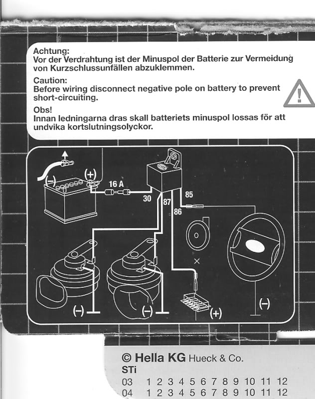

well you obviously don't have a factory install so there is more guessing involved and I try to refrain from commenting on the install itself.
You don't need to remove the lights, you could simply disable them ... and I'd do this at the same place I suspect your problem lay - the relay.
Do you understand relay's? If so, I'd simply remove the 'power in' line to disable the lights.
This diagram shows how to wire a set of horns using a relay, but if you can follow it, also shows how to wire any simple accessory with a relay and a switch. For your purpose the horns are lights and the horn switch is the power tap to your fog lights.
More important is understanding the 4 terminals on the relay which are labeled with numbers.
85 & 86 are the pair that form the control or input side. When this side is HOT the other side turns on. 85 - 86 is the low power side, 12v but minimum amps
30 & 87 are your 'high power' side, controlled by 85-86 side. 30 is typically a direct tap from the battery and fused, sending power INTO the relay's high side and 87 is the high power out, going to the lights. (most MINI light install get the power for 30 by connecting to the big red power cable that feeds the under bonnet fuse box, comes into the back of the fuse box)
To disable, disconnect at terminal 87 or just pull the inline fuse you SHOULD find between the battery tap and the relay as you see in the schematic above. You battery tap is probably at the battery cable connection to the under bonnet fuse box
To trouble shoot I'd start by checking the wiring here and on the fog light tap . .
