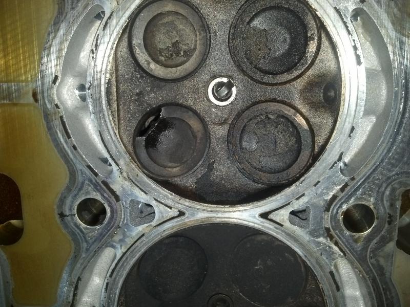

Machine shop thinks defective exhaust valve. I think carbon buildup may have played a part as it was pretty gunked up, hence why I'm planning to put something in the pcv line to prevent oil vapor getting sucked into the engine. I've attached a pic of the broken valve. I have some video somewhere I took with a boroscope of the intake valves, they were gunked up beyond belief, so I want to try to prevent problems again.
