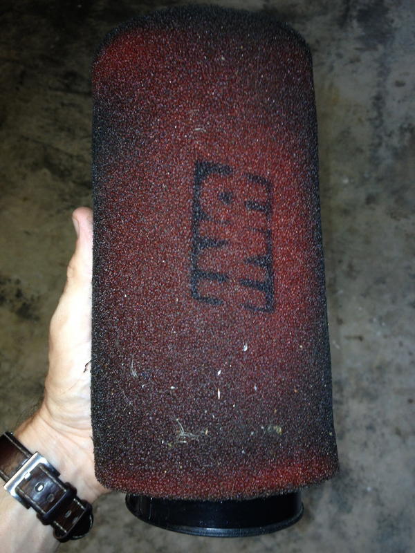

And both air filters...
Attached Thumbnails Preventative maintenance - age versus mileage-img_0466.jpg   Preventative maintenance - age versus mileage-img_0455.jpg
