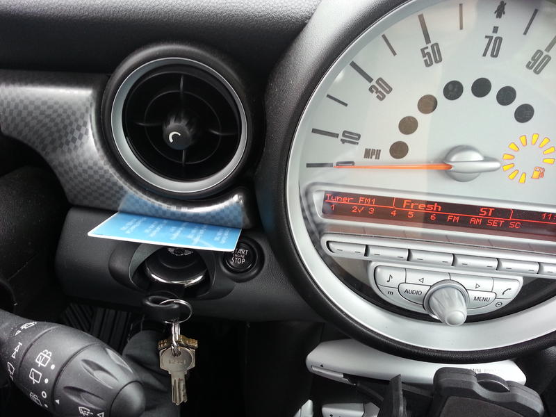

Hi, a week ago my mini began throwing the key with a line through it error indicating that it was not recognizing my fob. At one point it got so bad that I couldn't turn on my car and the electronics wouldn't come on. My remote unlock was acting strangely too. Not unlocking all my door and trunk would not latch.
I haven't fully confirmed this yet, but after a week of testing I believe it was caused by my company's new RFID badges. I keep my badge tucked in the slot above my ignition slot (see pic). Apparently the new badge was creating interference because, by whim, this week I resituated the badge far away from my ignition and the problem resolved! I put the badge back and it started having the issue again.
I couldn't find any other reports of this, so I'm not 100% sure. Hope this helps someone down the road.

The immobilizer chip in the key fob uses RFID, so I think it's quite possible that your badge causes interference when placed so close. However, I can't think of any relationship to the remote lock.

Interesting, I've had my mini for two years now and it just started happening after the new badges, but I'll do some more testing to be sure. I did consider the proximity thing since the new badge must be held within an inch of the readers whereas the old one (which I also kept above my ignition) had a five foot range and caused no ill effects.
