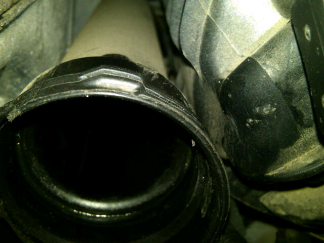

The rear of the water pump housing, water tube in center
[IMG][/IMG]

The thermostat housing end of the water tube

Here is a picture of the Water Pipe "tube" .
http://www.ecstuning.com/Search/11537589713/
There is a clip on the end that hold the pipe to the thermostat housing connection . Its separate from the part. Pull the clip and it should come off the slot. Then the thermostat housing can be separated. Did you disconnect the thermostat housing completetly from the engine head / coolant hoses / harness connections ?
Clip.
http://www.ecstuning.com/Search/11537548652/ES25118/
Water Pipe connection to thermostat housing on the rear side bottom.
Thermostat housing:
http://www.ecstuning.com/Search/11537534521/ES25098/
Thanks hope that helps.
