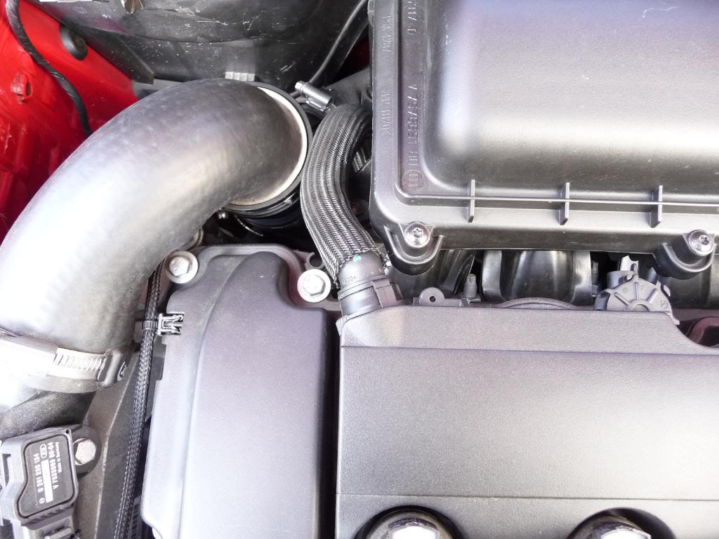

pcv hose off the valve cover? are there any pics where i can have a look at that, just to know what exactly you are talking about?

This Hose/Line that connects to valve cover. It will commonly break at either of the connection points, or somewhere along the hose line due to excessive blow by for long periods of time.

i think you could be absolutely correct! but is it the red or green one?
green. it goes from your valve cover to intake manifold.
