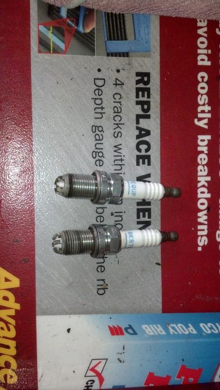

Here is plug #3 on left and #1 on right
Attached Thumbnails Spark plug blow out #3 and now Dreaded P0303 code need help.  MSD coil-oct2012-146.jpg

The compression check will tell you lots....might be worth spending a few $$ to have it done...imo wet and dry, they both can tell you different things.
You can use an ohm meeter to check the wires before spending $$ on a new set.
