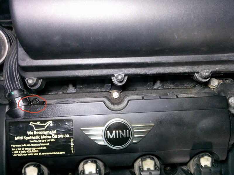

I have the similar issue.
Did you guys just changed the gasket or the valve cover as well to fix the problem.
I have both near spark plug area and around the corner areas leaking.
Would you recommend changing the gasket first to see if it fixes or
the valve cover since there is newly designed (new part #) cover?
Also, what is the timing chain tensioner seal? my dealer quoted me changing both gasket & seal.
Attached Thumbnails Oil residue on top of valve cover-oilleak.jpg   Oil residue on top of valve cover-oilleak2.jpg   Oil residue on top of valve cover-oilleak3.jpg
Old Nov 24, 2013 | 11:05 AM
  #29
CHKMINI's Avatar
CHKMINI
Posts: 1,604
From: Over at the other site
Are you running an OCC and if so, have you blocked the one side (curb side) to force everything to the catch can? This has been known to build pressure and cause the exact oil trace that you are seeing. (I can't see the pictures on my phone)
