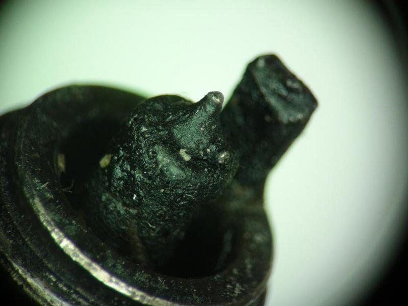

Can a piston break my spark plug electrode?
Finally got all 4 spark plugs back from Scottsdale Mini after they replaced my engine. Went to Ontario Mini and shown the spark plugs to the service manager and was told the broken spark plug ground electrode was due timing jumped caused the piston to smashed into the spark plug and they’re not responsible for the cause of my blown engine. Even though the broken spark plug shown no signs of being mashed or any damaged to the positive electrode and the break was very clean as shown in the photos. Can someone explain to me how can the piston come into contact with the spark plug and caused it to break?

That's up to them to explain. I don't see how it could happen, as the spark plugs do not move within the combustion chamber. They're always in the same place, so if the pistons could ever hit them in their regular travel they would hit the plugs every single time.
So it sounds like they're feeding you a big ration of BS to get out of having to pay for the engine work.
Old Feb 21, 2012 | 05:08 AM
  #41
MiniDeLux's Avatar
MiniDeLux
Joined: Dec 2011
Posts: 211
From: 3rd Outhouse on the Left, Luxembourg
Two very remote (and I'm not even sure they are 100% possibile) possibilities: crank bearing (which could explain the timing jump) or piston rod (and/or rod bearing) are shot. Over-revving when downshifting can damage the rods. It's not inconceivable that it could also be related to the timing issue too. If there was actual contact between piston and plug, there will be a mark on the piston.
Otherwise foreign debris inside the cylinder hit it. If so, it's probably still in there. Have a look with a scope. Like I said before, if the engine was over-revved, this could be related to valve damage that shed debris into the cylinder. This may have struck the plug.
Could also be due to detonation resulting in a bent plug or an incorrectly fitted plug.
In any case, your entire sequence of events is strange. When you say:
"Drive the for few days and it ran fine and last Sunday my nephew drive it from Chino to Arizona and noticed the check engine light came on"
This is not how a plug would catastrophically fail. You'd hear it and feel it, it wouldn't be a simple CEL light coming on. Furthermore, were there debris in there after the walnut blast the problem would have occurred when you initially picked up the car after the walnut cleaning. It certainly wouldn't have "run fine for a few days".
You probably won't like what I have to say and I understand you're upset, but realistically I don't see how this is the garage's problem. According to you, the car was fine until your nephew got into it. If I were you, I'd be talking to your nephew and checking whether or not the ECU registered a redline.

A little search I did turned up three possibilities for a piston hitting the spark plug. One, bad rod let the piston travel farther than it should have. Seems unlikely. Two, if the spark plugs were installed incorrectly, they may have been set deeper than was proper resulting in them hitting the piston. I believe earlier in the thread you indicated they had taken plugs out when doing some other work, so this seems like a possibility. Three, if the timing is off causing improper detonation, it may be possible the detonation was strong enough to damage the plug without an actual strike with the piston occurring. Would have to look at the actual piston head for evidence of contact. This sounds like the reason (sort of) you got from the SA in blaming it on the timing jump.
Old Feb 21, 2012 | 07:01 AM
  #43

Don't understand your theory #2, spark plugs installed incorrectly, set too deep. How can you install a plug too deep? You screw it down on a seat, and torque it. The plug can only go in to the point the where the plug seat meets the head seat. The only way to get a plug deeper into a combustion chamber is to install a longer (wrong) plug and the piston would hit that plug as soon as you start the engine not magically a few days later.
Old Feb 21, 2012 | 07:39 AM

I'm not real sure. The various threads I've found usually indicated it would be something like the plug got cross-threaded which then allowed it to extend further into the cylinder. I would think that would be a pretty easy thing to see though once you pulled the plug (much less feel when installing the plug). And like you, I would think if that were the case, the strike would occur the very first time the engine started up.
Old Feb 21, 2012 | 08:52 AM

If the plugs are the correct parts for the car then cross threading will not result in seating the plugs any deeper into the cylinder than proper threading and would most likely result in the spark plug being unable to completely seat as designed. Typically anything that you cross thread is started slight askew and "seems" to fit at first but suddenly becomes very difficult to tighten all the way.
IMHO the well documented known timing chain issue is the core cause... (best guess on my part having not inspected the engine)
Didn't look back over this thread, but did the valves hit the pistons?
I've only had one engine "blow up" on me over the years. It was a racing Honda SL70 set up for TT and Scrambles. Had domed pistons, big valves, massive cam and very tight tolerences. This thing was pushed to the limits; running nitro-alcohol blend.
Slaped a license plate on it one day after school as a teenager and headed to Saddleback Park in Orange County, CA for some track time. On the way home I ended up racing a Honda 750 down Champman hill. Yes, a 70cc racing a 750cc. Was in the lead until it exploded!!!
I over rev'd it and put the valves through the piston. One valve broke off and was fused into the piston dome. Oops!
Funny memory now, but not at the time. Almost went down hard on the pavement when it blew...
ADDED: Hey Satang, did you ever get a report from the "black box" CPU telling you what was happening at the time it went?

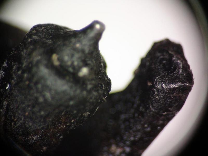

More photos of the spark plug
The engine was never over rev and the all four plugs are oem and only time they're taking out was during the carbon blasting. As you can see the spark plug shown lots of deposit on them and the broken plug shown no signs being hit by the piston.
Attached Thumbnails Broken Spark plug caused 00 Engine damage-spark-3.jpg   Broken Spark plug caused 00 Engine damage-spark-4.jpg   Broken Spark plug caused 00 Engine damage-spark-5.jpg
Old Feb 22, 2012 | 08:17 PM
  #50
SooperCuperErik's Avatar
SooperCuperErik
Joined: Apr 2008
Posts: 566
Wow that is very much coated with carbon. Everything you keep telling us points towards the dealers fault. Maybe the tech dropped the plug on the tip which weakened it enough that a few heat cycles made it fail. ...micro fractures/cracking leading to liberations are seen by this.
