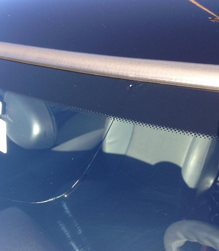

Took a rock the windshield the other day, had it been a hair higher it would have missed but no such luck. Anyway, Mini quoted me $2,000 to replace it; not sure how they could keep a straight face while doing it. I found a place that sells PWG glass (Ace Glass) here in Honolulu and they did it for $420. They did a great job and it's great to see through a clear windshield; the old one was so pitted already. Hope this one is tougher the than the OEM one.

I thought of an instance where a replacement windshield had leaked and caused damages not covered by MINI warranty.
A friend of mine had water dripping off interior rear view mirror and into radio, during a rainstorm. Neither mirror nor radio were covered by warranty due to outside influences, i.e. water leak caused by improper installation. Lesson to be learned is use a reputable installer who will guarantee their work.

There is also an extremely good chance that the dealership does not do windshield replacement in house. They most likely contract out the work to a third party who knows the ins and outs of windshield replacement.
By having the windshield replaced through the dealership, you are in effect paying them as a middleman and throwing your hard-earned $$$ away.

But BE CAREFUL! There are specific sealer strips that need to be addressed. The MINI windshield is more technical done right than most glass installers care about and this will potentially cause you some grief. And this can occur through the dealer also, unwittingly. I have found out the hard way and the way I found out about it on my 2008 just a couple weeks ago was by deciding I'd replace the "apron" the hard shell plastic under the wipers. The rubber on the top edge seals against the glass and mine was getting tatty from age etc. When I took it off to replace after the glass install, I discovered that the sealing strip, which also serves as the tongue and groove retention for the apron was not there! The upper edge seal also fits snugly on the window edge like the lower and must be put on prior to install. There are also foam sealers under the A-posts. The buttons that hold it on have foam washers on them as well that form a seal against the body. When I took it all apart, it was all messed up. Fortunately, when I found a MINI tech who knew what he was doing, he was able to remove the new glass without breaking it. I'm out about. All the sealers new will run you about $100 and you need 'em. If someone tells you they can provide a new rain sensor windshield installed for $225.00, run.
One thing I forgot to mention: I cut out the middleman. I used the glass company the dealer does presuming they knew what he hell they were doing....NOT!

My car's out of warranty but I still wouldn't let just anyone change the windshield. This place I found called Ace Glass is very reputable, everyone that has dealt with them had good things to say. You can tell when someone does a quality job; the car was spotless, the windshield perfectly clean, they didn't break anything, no debris left inside or on the dashboard. Other than a crackless windshield, I couldn't tell they changed it. Guess you just have to shop around and ask other people who they recommend.

I hear you.... just check to see if your apron has any give or movement to it in the center of it. Just push down on it centrally and see if the rubber seal against the window moves. It shouldn't. Or pull the section off over the battery and look to see if there is the groove available for it to lock back in to. A Ford it ain't. The guy who did mine - experienced they said - sealed the new screen right over the old sealer and buried the VIN. Real nice. Real experienced. Knock 'em out, get paid and do another.
