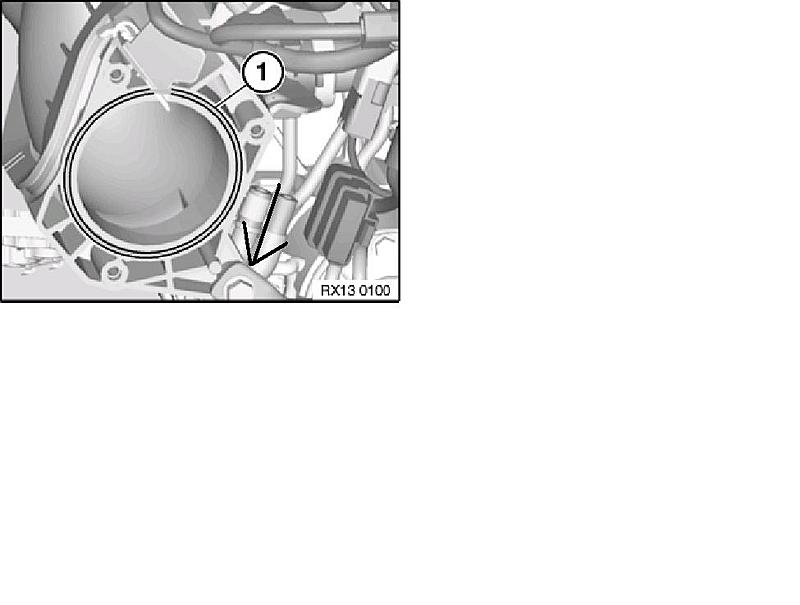

Ah. See I tried to remove the inlet manifold. I took out the 5 bolts that hold it in from the top, I didn't see the one underneath. So can you point out where it is on this photo?

If you go straight down from the oil catch can you have installed its down there. It is a 10mm bolt that is located under the throttle body. Many people get to it from the bottom. I personally have smaller arms and hands than most so I can get to it from the top. If doing from top use 10mm deep on a 1/4 drive ratchet. If you want flex head ratchet that would be best. Feel for it by hand. attached a photo that shows bolt. in the photo the throttle is removed but that is just in that photo. you do not need to remove the throttle
Thanks so much (that photo is not of my car, but I have a catch can in the same position, and a DoS intake)

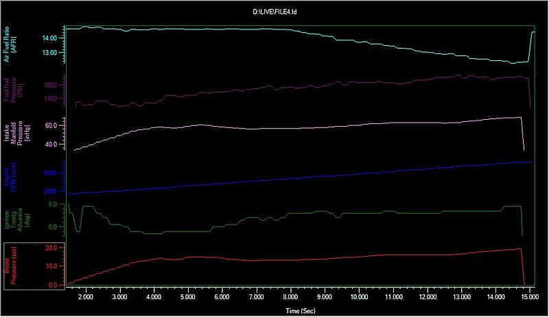

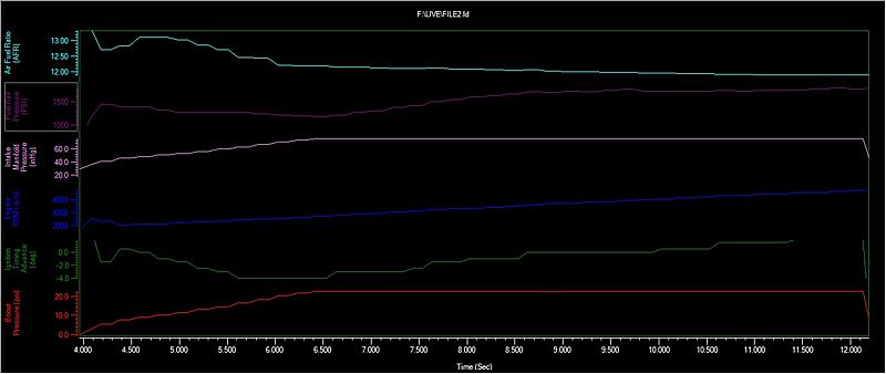

Update: I used a toothbrush and some subaru upper engine cleaner to scrub off some carbon, and did the BMW fuel system cleaning (the one that uses a standalone fuel pump and tank filled with solvent and fuel). Obviously because I used a toothbrush, I couldn't clean the valves all that well, but I could clean the surroundings quite well, and got a LOT of gunk out. All to no avail. Made zero difference.
I bought an Auterra DashDyno SPD ProPack (just quietly, the thing is AMAZING).
I logged AFR, Boost, Timing Advance, RPM, Intake Manifold Pressure, and Fuel Rail Pressure, using 4th gear from 2000-4700 RPM. I logged two runs, one using my Stock ECU map, and the other using Jan's tune. I've attached both pics, feel free to have a look and see what you think.

looks to be running pretty rich on the high boost run. readings do not show much difference in timing curve. Looks as its over fueling, if you see in the high boost run that boost (20psi) and fuel ratio(12:1) both stay about the same from 6 seconds on. compared to normal tune where fueling adds on the second boost increase. mini programmed in an overboost where it hits full boost. comes down a bit then boosts up again as you can see. I am not a tuner but your tuner should be able to figure something out with the reading you have provided.
