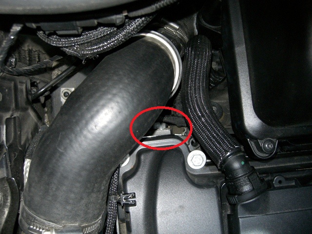

Originally Posted by EuroTechsAZ
Here is picture of the tensioner where it goes thru the head to put pressure against the timing chain guide...
I'm trying to orient the photo of the head to what I'm seeing under my bonnet; can someone describe to me where to look for this tensioner bolt on the head?
Old Mar 24, 2011 | 11:40 AM
  #40
Bigprfed22's Avatar
Bigprfed22
Joined: Jun 2010
Posts: 2,308

EuroTechsAZ's Avatar
EuroTechsAZ
Joined: Feb 2011
Posts: 299
From: Tempe AZ
In an invisible car that picture would be taken from the passenger side , you would be rearward of tire slightly looking forward. On a real car the way to see it is to remove boost hose that connects to throttle body and look straight down. If you plan on upgrading the boost hoses it would be a good idea to put a wrench on it to see if its loose or not.

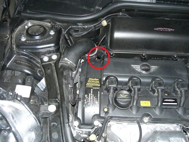

  #42
BBoshart's Avatar
BBoshart
Joined: Jun 2008
Posts: 157
From: Seattle
I tried to show where the tensioner is in relation to the engine bay. The first pic shows where to look (it's been raining a lot so don't mind my dirty engine). The second shows the head of the tensioner. You can almost touch it with your fingers.

Originally Posted by Bigprfed22
Touche, toque listing?
Are you asking for the TORQUE the tensioner is supposed to be tightened to? If so, I'm not at home with my computer that has the BMW TIS software. I'll look when I get home late tonight if nobody else has replied by then.

Old Mar 24, 2011 | 07:07 PM
  #47
timfitz63's Avatar
timfitz63
Joined: May 2010
Posts: 641
From: Lorena & San Antonio, TX
Thanks "EuroTechsAZ" and "BBoshart!" That clears up the mystery!

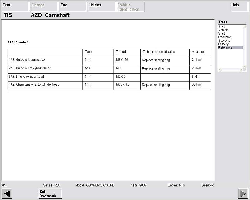

Old Mar 28, 2011 | 12:18 AM
  #48
BBoshart's Avatar
BBoshart
Joined: Jun 2008
Posts: 157
From: Seattle
I forgot that I said I'd look on the TIS and post the torque spec. The TIS I have dates back to 2007 (the most current version I can find) so I'm not sure the spec is still current, but it lists the chain tensioner as 65Nm, or about 48ft/lb.
Old Mar 28, 2011 | 07:00 AM
  #49
Bigprfed22's Avatar
Bigprfed22
Joined: Jun 2010
Posts: 2,308
Thanks!

grgramps's Avatar
grgramps
Joined: Jan 2010
Posts: 324
From: Western NC
This has been a fascinating thread and much appreciated! I have a 2010 MC and have peered down there and see the tensioner hiding beneath a hose. It looks like a relatively easy job to put a wrench on it to check torque.
Since it looks like a rather large size I wonder if anyone knows the socket size??
Now why have so many of the tensioners come loose? It's been explained that some were probably only finger tight. Do you suppose that's because one person is installing finger tight and another person is responsible to torque it? I hope, by now, they have one person doing the job with the promise that he will be on the dole if he fails.
