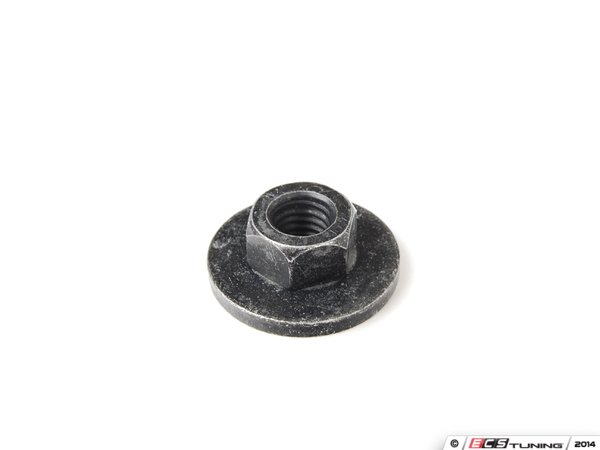

Here are the nuts and bolts. One each per hinge.
HEX NUT WITH PLATE #35
http://www.ecstuning.com/Search/SiteSearch/07147139131/ES2674395/
Torx Bolt - Priced Each #3
http://www.ecstuning.com/Search/SiteSearch/07131166764/ES2136365/
#2 is the actual hinge . I would spray with penetrating grease at least yearly, like door hinges and the hood latch and locks as prevention.
