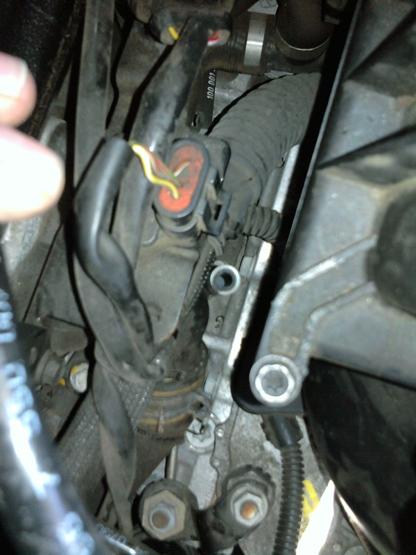

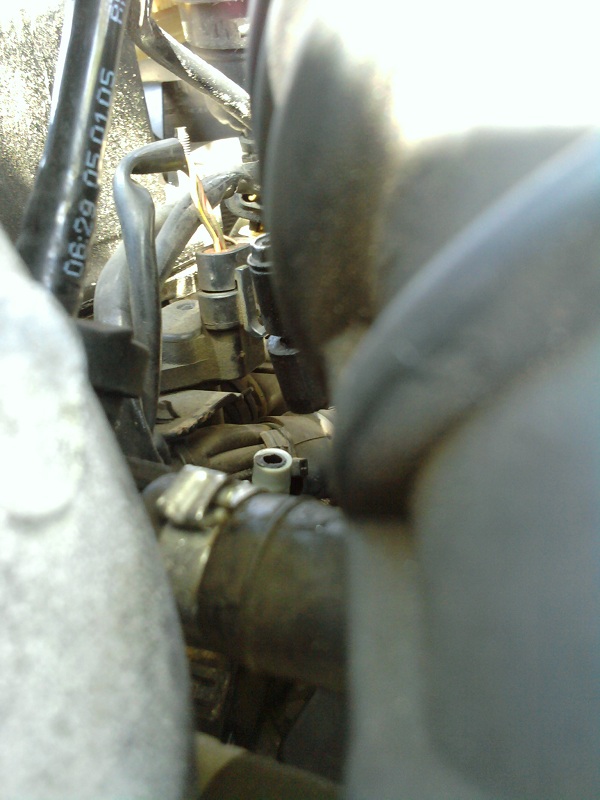

I just reinstalled my supercharger, and i have a hiss now.
It's a vacuum line, because i can feel it sucking air.
But i cant find where it goes. It comes from the plastic tube from the supercharger to the TB.
Maybe the internets can help.... Pics attached.

I believe it goes to the TMAP sensor, it connects from the sensor to the charge pipe.
#20 in this diagram http://www.realoem.com/bmw/showparts...35&hg=17&fg=05

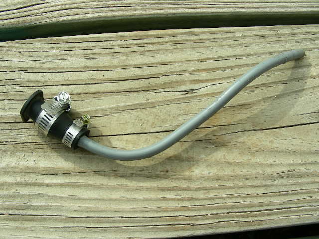

It's from the MAP sensor going to the supercharger intake duct. You can replace it with a new one or fix it like this.
