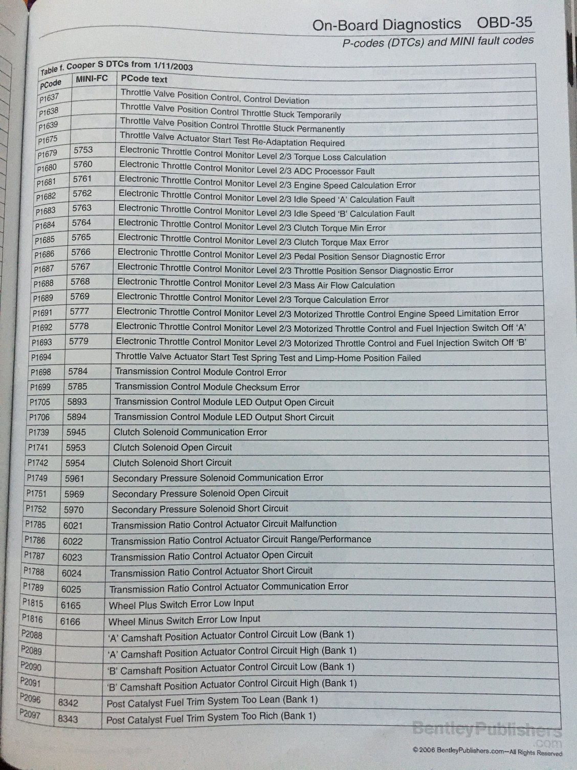

One funny note: I checked the Bentley manual on this and it was beyond useless. Even the torque specs seem fishy: under "Other Mechanical Maintenance" in the Maintenance chapter, it says to torque the oxygen sensor to exhaust manifold at 37 ft-lb. Under Exhaust system in the Engine Chapter, the tightening torque table says to torque "oxygen sensors to exhaust 29 ft-lb". Part of me thinks the first one is for the pre-cat sensor, and the second one is for the post-cat sensor, but then 1) why is one torqued to a different spec than the other? 2) why does it say sensors, plural?
