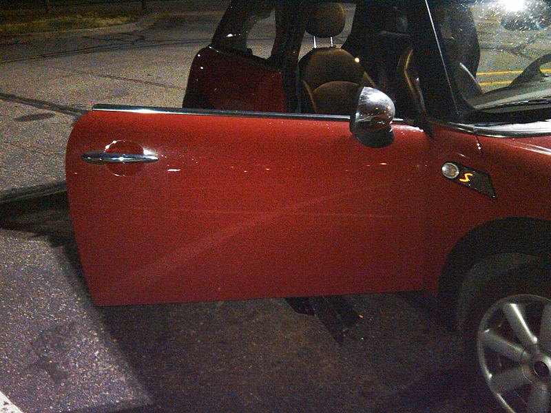

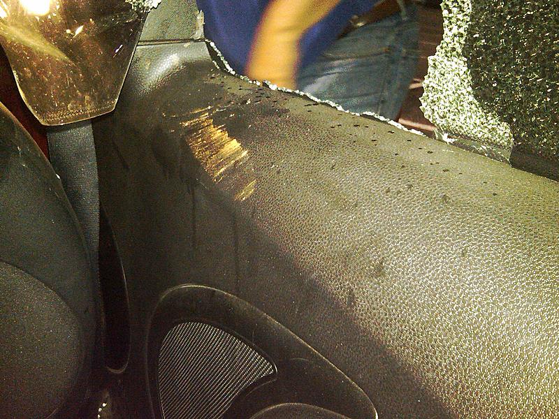

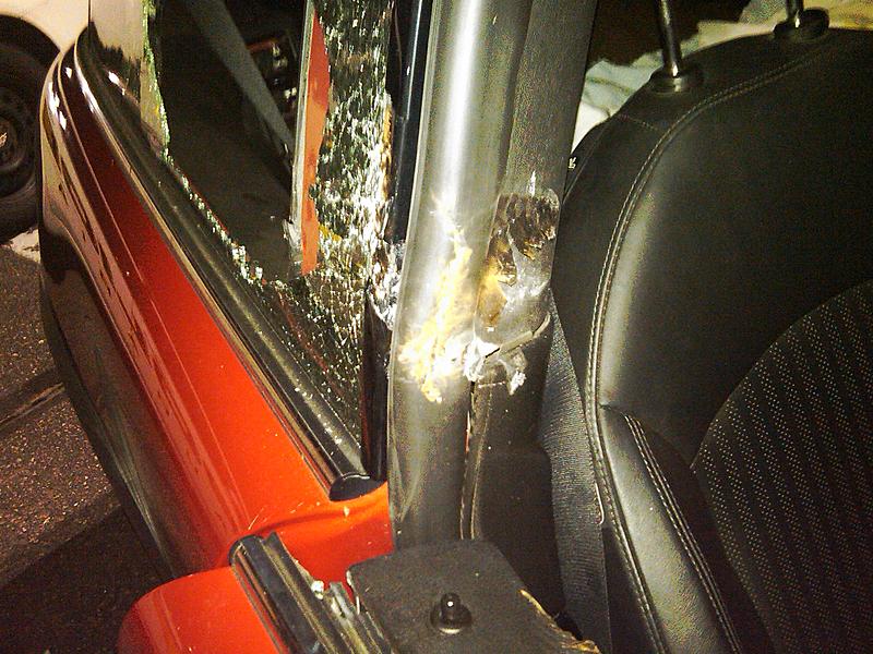

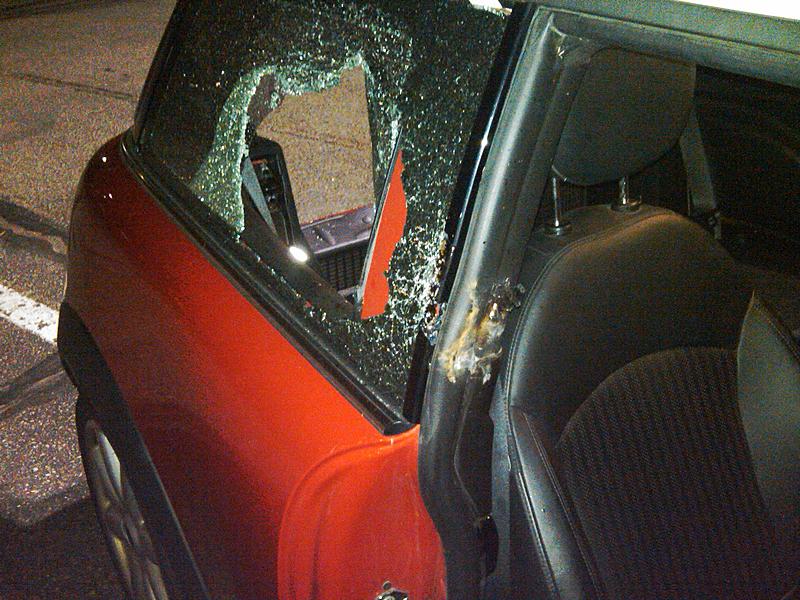

Hello everyone,
Last night while driving back home on I-25, at around 9:30 pm, in Denver I heard a loud explosion sound. I looked over to the passenger side of my car to see the front passenger window shattered and the rear window shattered as well. The only thing keeping the window together was the tint film. Luckily, I did not lose control of the car and was able to exit the highway safely and parked in the Aururia Campus parking lot.
Initially, I thought someone had thrown an object towards my car, either intentionally or unintentionally. I called Denver police who responded promptly as well as campus police.
Now armed with flashlight we start looking at the damage in the vehicle and all indications seem to suggest that something occurred within the vehicle. There was little to no body damage on the outside other than where one window ends and the other begins. What’s even more bizarre about this is that there was some sort of liquid stain on the interior side of the passenger door, the passenger seat, and below the back window as well as something that looked like a copper/rust stain that was also on the inside of the passenger door and below the back window. Finally, there is a section on the passenger door, right below the lock where it appears that something cut through the leather.
I am no expert when it comes to knowing how vehicles or their electrical systems operate, but, I along with the police officers at the scene concluded that something must have happened with the airbag system. The side airbags did not deploy at all, and I don’t know if that was because they were not active since no one was sitting in the passenger seat.
I have attached some pictures regarding the incident; any feed back or comment is greatly appreciated. Sorry about the quality of the pictures, they were taking with a camera phone at night.
The car is currently at a dealership where I was told that there was no malfunction of any sorts and that it appears to them that something hit my car. The police officers and I were unable to find any debris inside the vehicle.
Attached Thumbnails Bizzare Incident-img00508-20100707-2228.jpg   Bizzare Incident-img00513-20100707-2230.jpg   Bizzare Incident-img00515-20100707-2231.jpg

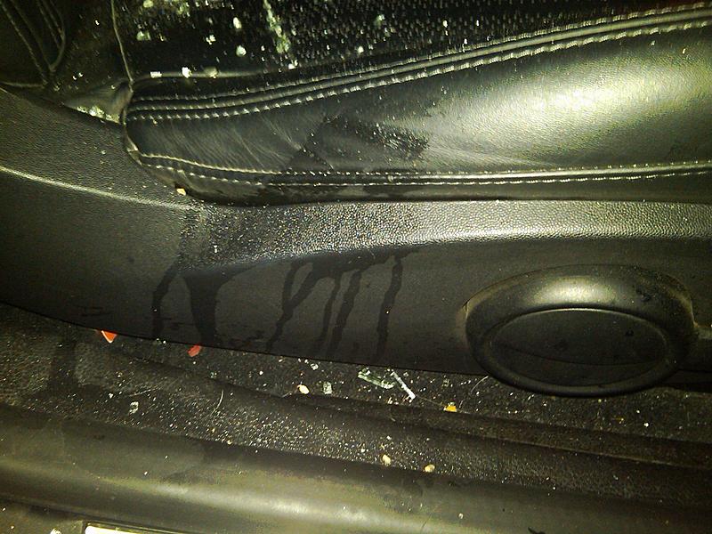

One more picture. I do have plenty more if anyone is interested.

Giessy,
do you have a photo of the side of the seat closest to the door damage. It almost looks as if the firing mechanism for the air bag in the seat blew with out filing the airbag. This could be a real problem in an acident if the airbag needs to deply and the fieing mechanism explodes instead and then burns someone.

Looks like rust in your pics, like off a cable or chain that may have been winged at you(?). Also damage to the trim on the outstide makes me believe that something was tossed/kicked up at you. Not sure about the "liquid" stains. Great job maintaining control!

schatzy62, unfortunately, the first picture I posted is the best one that I have for the seat side closest to the door.

Here are a couple more pictures. My insurance company is sending out an estimator who is going to look at the damage. This should be interesting because my insurance policy does not cover manufacturer defects and I don’t know if mini would acknowledge if it was a manufacturer defect.
Attached Thumbnails Bizzare Incident-img00514-20100707-2231.jpg   Bizzare Incident-img00530-20100707-2314.jpg   Bizzare Incident-img00534-20100707-2315.jpg

I am agreeing that it looks like something hit right between the windows. It may just be the photo, but it sure looks like impact marks.
Chain seems like a good fit to me.

Holy crap! That's weird. Can the police test the area/residue for acid? It appears in the pic of the inside passenger door that something caused the vinyl to bubble and that orange-ish/rust-colored staining looks almost like a liquid stain. Glad you're safe above all else but will definitely keep an eye on this thread so keep us posted as you come to some sort of resolutioin. Good Luck!

It's pretty obvious that something hit your vehicle. Possibly it was an object kicked up by a vehicle near you or something that fell off of a truck. I think you will not have a problem with the insurance company taking care of it. You will be out the deductible though. Glad you weren't injured.

My thought is something came thru the passenger window, scraped the inner top of the door, and hit the pillar, and fell back to the road. It just didnt come into the car.
Road debris, I am thinking, something that had some sort of liquid or goo in it, like an old can of something. Needs a forensic exam!!

I wish I could see how much glass is on the floor inside the car. With you and the police (who saw all of the damage) guessing that *it* came from in the car, I'm guessing that there was very little glass inside. If it were a chain or something else from outside, I believe there would be a ton of glass in the car.
I'm completely with CalicoGal - if that goo could be analyzed, and it turned out to be MINI goo (as in part of the airbag system) then they would have to make good on it.

Back window shattered from impact of object with B pillar, not from a direct hit. I agree with poster above. Some rusty contruction equipment tossed by some misguided lad, or bounced from the back of a truck or kicked up from the roadway by another vehicle onto your car.

I agree that it looks like some kind of object (container, rock, aircraft toilet ice, deer, etc) was flung at your car, busting the front window, and hitting the b-pillar, causing the rear side window to break. The one side shot shows the glass stress cracks radiating from the impact area. A deer running into the side of your car could explain the damage and the moisture, but there would usually be hair left on the car.
If it had been an airbag inflator deploying, you would definitely know it. Had the inflator fired, there should at least be some airbag trying to escape. They do partially fire sometimes (gas leaked out or missing propellant), but there should still be exit residue from where the airbag is located and a definite gun-powder smell. Either way, if any airbag fires, the initiator becomes an open circuit and would trigger a warning. The system checks electrical resistance for all airbags each time you start the car.
