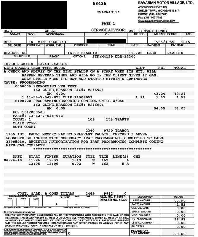

Ok, here's the service report of what was done when I brought my Mini into the dealer for the hot start problem. Since then (which has been a while now), its been fine & never happened again.

Tiny that image is so small I can't read any of it.

I'm trying to upload a bigger one.....giving me issues

This better? (on a full screen)

They charged you for the repair? It should be under warranty!

Yeah that's what I was going to ask. Did they tell you why they needed to charge for this?

No, they didn't charge me anything...I guess those were the prices of what it was worth....

OK whew. Glad to hear they were able to fix your issue.
