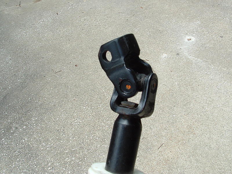

U joint?
I just disconnected the rack from the lower u joint. It was very difficult as the U joint did not want to bend up and away from the rack spindle. The other axis bends just fine, but the rack end of the U joint will not bend the other direction. Seems like the U joint may be culprit, is this possible? Can just the U joint be replaced? I moved the wheels and rack lock to lock while disconnected and didn't feel any lumpiness.

Found it
The culprit is a bad U joint on the lower steering spindle. Ordered a new one from ECS $149 shipped.
