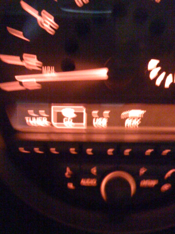

My tuner periodically disappears (dashed out) and the audio system switches to the CD automatically. The audio system sometimes appears to not remember how it was shutdown, e.g. shutdown car with the radio on, and when the car is turned on again the audio system defaults to CD.
Duplicated this experience at the dealer, the system has been reprogrammed twice now, but the audio system is still doing this.
2008 Mini Cooper S with Harmon HD radio, no NAV.
attached picture is horrible as it was taken with phone camera, but you can tell the tuner is ---- out.
Anyone else experience this of have any ideas?

I have heard of this twice before and both times the dealers replaced the head unit. And if the dealer has reprogramed the car twice it is time for them to replace the head unit. There is probably some kind of loose connection in the head unit it self.

Since I just added the HD radio tuner to my car myself, I know that the dashed lines means your head unit is not communicating with the IBOC/HD tuner in the trunk (via the MOST bust/Fiber optic lines). In DIS/ISTA the signal power (brightness) of the fiber optic bus can be reduced to troubleshoot intermittent issues like this. Especially since they have already replaced the IBOC tuner for you I would suspect one of the fiber lines has been damaged or more likely one of the connectors has been installed wrong.
Also as the MOST bus is a ring topology, all other devices on the bus need to retransmit the signal. So if you have Bluetooth/USB ULF, Sat tuner SDARS module, CD changer, nav or the OEM ipod adapter any one of those modules (or it's connections) could the problem (including the main head unit where the ring originates). For diagnosing the ring, each module can turn down the fiber brightness so a problem spot can be determined.
I found the factory had left my fiber lines in a tight ball wrapped around wires above my fuse box (that serves as the connection point for diagnostic). It was a complete mess, the bends WAY tighter then the factory recommendations for minimum bend radius. However, my system is working okay with the two MOST bus modules I added, ULF and IBOC. But I was very concerned when I saw how shoddily it came from the factory.
