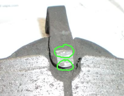

Lastly, the GEN2 MINI has TWO brake wear systems. One is a miles counter that tries to judge your driving vs wear. Not much different from the oil change warning ... it mostly counts miles. When it gets to zero you get a light. You can reset that light thru the OBC. First time mine came on in my 7, I looked at the pads and reset the light ... I had plenty of pad left. The other system is the wear sensor which trips when the pad gets thin enuf to wear the sensor tip off and break a wire. The only way to turn off the light in this case is to close the short caused by the broken wire in the sensor. Two ways to do this: replace the pads and install a new sensor; cut off the sensor and splice the sensor' wire ends together . . .
btw - because of how the sensor works .. cleaning off gunk won't do anything. One could say it TRIPS by having the gunk cleaned off . . .
here's a tripped sensor, still in the worn pad ... look closely in the circles and you can see the stubs of the wire imbedded in the plastic. The pad thinned allowing the sensor to contact the rotor. As the rotor ate the pads it also ate the tip of the sensor. Eventually the tip of the sensor wore enuf so that the imbedded wire loop was broken. The resulting open circuit causes the warning light.
